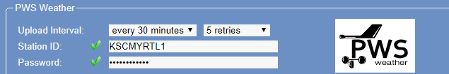

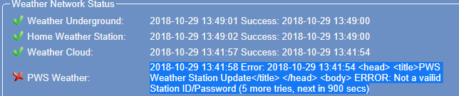

I am seeing one issue with PWS Weather. I keep getting the error attached below, however, the Weather Network page shows that the ID and PW are corr
ect (two green checks)
This worked fine with regular meteobrige/stick.
-------------------------UPDATE--------------------------------------
After more testing, I found that changing the retries to "None" fixed the issue. The error went away and it is now posting data to PWS.
