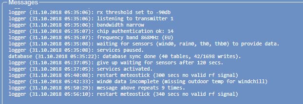

During the tests for upgrading from Meteobridge to Meteobridge PRO (red cap), I lost, apparently without reason, the connection with Vantage VUE station.
The connection with ISS was good since the very first moment but looking in the records from past hours the valid rf signal was going up and down.
And no chance to get a valid rf connection into the last couple of hours.
I performed, also, a couple of reboots, but no improvement.
The meteo station correct functioning it is confirmed via old Meteobridge.
Please find below the hardware settings for Meteobridge PRO.
Thank you!
system messages.JPG (42.34 KiB) Viewed 1794 times

Try setting RF Sens to -80db and
What's the distance from the MBPro to Vue ISS?

The distance between Meteobridge and ISS it is around 5 meters.
I didn't face any issue in the last month since I have powered on for the first time.
In the last hour it seems that I got back some valid rf signals - 26 valid records.
I will follow your instructions and I will try RF Sens to -80db.

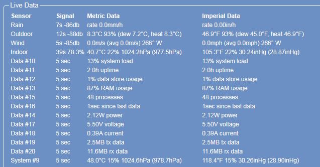

I was not able to get the connection with RF Sens to -80db, but the connection successfully as returned to -90db.
Below are the Live Data with RF Sens -90db.
Live Data.JPG (46.87 KiB) Viewed 1791 times
