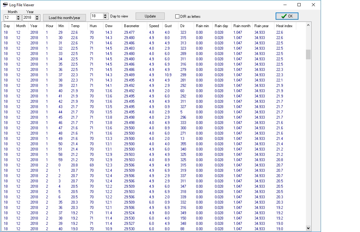

I'm having a problem with the Meteohub History Data Extraction function within Weather Display. When doing an extraction it misses some records. Sometimes I'll have a gap of 10 to 20 minutes where no data is extracted. This is particularly problematic when his happens at over midnight as the daily highs and lows don't get reset for the new day. I'm running meteohub on an ebox 3300 if that helps. I'm hoping somebody out there may know of this problem and have a way to fix it. I've attached a jpeg of the WD Data Log File. You'll notice that there is an almost 30 minute interval where no data is extracted from 2:06 to 2:35 AM on 2018/12/18. If I run the data extraction again chances are good that I will get data from that time period the second time around.
