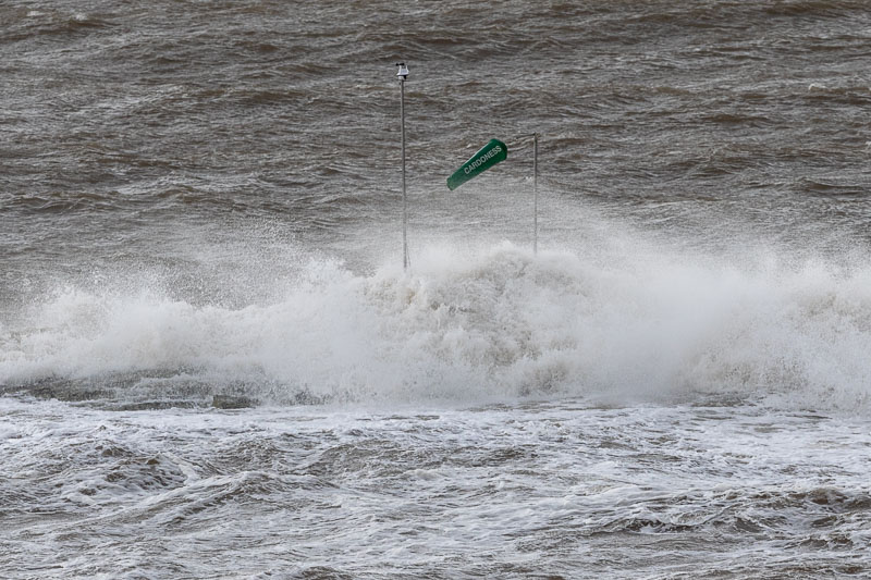

As a fellow windsurfer I appreciate your interest in the direction of the peak gust. I do not know the geography of your sailing location but in my location, cross offshore winds (which are in general great for windsurfing) are very gusty in strength and direction. However, what you are asking for would have little relevance to my location with a shore mounted ISS because the wind measured on the shore is greatly different to that experienced just a few hundred metres offshore. So even if I had the data you are requesting it would not help my windsurfing much as it would not be representative of the conditions I would actually be sailing in.
My solution was to mount a wireless ISS on a reef 400m offshore. The analogue windsock is of course a great indicator of both wind strength and direction while you are on the water.

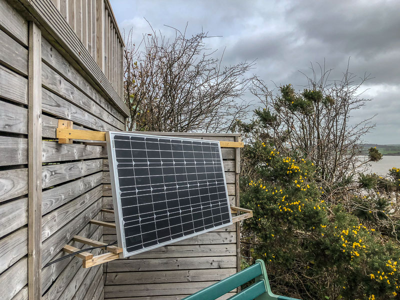

The MeteobridgePro is about 500m from the Vantage View ISS and receives the signal via a Davis solar power wireless repeater. The MeteobridgePro and attached Huawei USB 3G dongle are off grid and are powered by a 12V to5V USB converter which is driven by a 120W Solar panel connected to a 100W SLA 12V battery via a 10A MPPT charge controller.

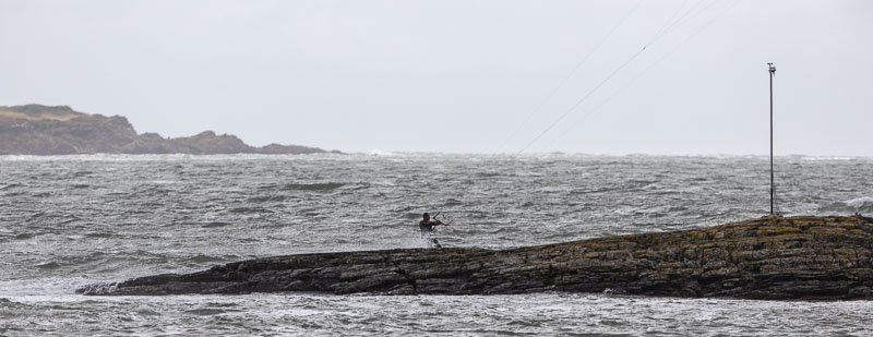

The kite surfers like the ISS mast to...
.. help gauge the height of their jumps.

Thanks for sharing this cool setup and the great photos!

thank you very much for sharing! You realized the dream of any wind/kite surfer: to have the anemometer directly in the water!!!!!
Unfortunately I live in Italy and here it is banned even to think to install something in the water or on the reef!!!
