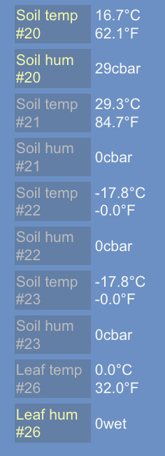

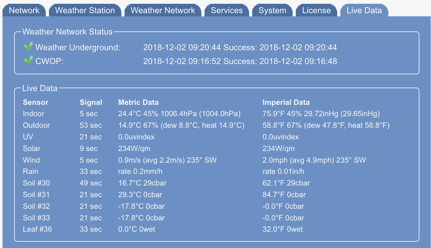

Below is the result of when I query the meteobridge via the command http://IP-ADDRESS/cgi-bin/livedataxml.cgi
The first SOIL result ("th20") is correct and the one I want to upload but the other 3 ("th21", "th22" & "th23") are not related to sensors that I have in place and I am unsure in meteobridge how to remove them.
I have said in meteobridge to "ignore sensor" for th21temp, th21hum, th22temp, th22hum & th23temp, th23hum and they show as greyed out on the web page but they are still showing up in the data feed and also in the "Live Data" section of the web page.
How do I fix this? Can I modify the upload to remove the data streams that I don't need?

<logger>
<THB date="20181201220244" id="thb0" temp="24.2" hum="46" dew="11.8" press="1004.1" seapress="1006.5" fc="-1" lowbat="0"/>
<TH date="20181201220228" id="th0" temp="14.1" hum="70" dew="8.7" lowbat="0"/>
<UV date="20181201220248" id="uv0" index="0.0" lowbat="0"/>
<SOL date="20181201220244" id="sol0" rad="160" lowbat="0"/>
<WIND date="20181201220248" id="wind0" dir="203" gust="2.2" wind="2.1" chill="13.8" lowbat="0"/>
<RAIN date="20181201220224" id="rain0" rate="0.0" total="0.8" delta="0.0" lowbat="0"/>
<SOIL date="20181201220212" id="th20" temp="16.8" hum="30" lowbat="0"/>
<SOIL date="20181201220248" id="th21" temp="29.3" hum="0" lowbat="0"/>
<SOIL date="20181201220248" id="th22" temp="-17.8" hum="0" lowbat="0"/>
<SOIL date="20181201220248" id="th23" temp="-17.8" hum="0" lowbat="0"/>
<LEAF date="20181201220236" id="th26" temp="0.0" hum="0" lowbat="0"/>
</logger>

As Meteobridge is receiving the information, I assume that there should be something within Meteobridge that will allow me to filter out the data I dont require.
This would then solve my problem.
Is anyone else reporting the soil and leaf wetness through Meteobridge to WU?
