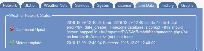

Trying to setup local dashboard without much success just get a blank screen are there any guides anywhere I can use especially for someone with limited knowledge :D
also have an error message on Live Data page ?

Looks like the dashboard SW parts have not all been installed on your NANO SD. Can you please do a reboot? May be the missing parts will be installed. If not, I will need a remote login. please send URL and password to "info(at)smartbedded.com".

tried a reboot no change,going to have to show my ingnorance here, how do I set up the Nano for remote access

There was a folder missing. Unclear why. I started install again and now it is working.
