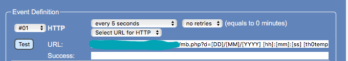

Posts: 1826
Re: Separately host HomeWeather Station poll Davis Pro V2 via MeteoBridge Pro over IP
hi
you can get 5 second updates using a different method quite a few users use this method
in the services tab set up to send every 5 seconds using the long manual inserted data strings ,this is what the template supports .things to note the make sure your server can handle the multiple updates many shared hosting especially low cost ones can not simultaneously process the very short intervals .
template module update intervals staggered to try and preserve server performance
temperature module is set to update every 60 seconds
wind module can be set to update every 5 seconds by default it is set to 10 seconds
rainfall module updates every 50 seconds
barometer module every 5 minutes
UV module every 2 minutes
and so on ......
as you can see most modules update according to data i.e no point in updating temperature at 10 seconds whilst it may change but im sure the 60 second period would reflect the change..same would be for barometer etc no point in having it update in periods of seconds .
disable Homeweatherstation API option first otherwise you have multiple instances and probably duplicate times recorded in mysql
then use services tab select a new HTTP request and insert changing the yoururl.com to appropriate url
https://yoururl.com/mbridge/mb.php?d=[DD]/[MM]/[YYYY] [hh]:[mm]:[ss] [th0temp-act:--] [th0hum-act:--] [th0dew-act:--] [wind0avgwind-act:--] [wind0wind-act:--] [wind0dir-act:--] [rain0rate-act:--] [rain0total-daysum:--] [thb0seapress-act:--] [wind0dir-act:--] [wind0wind-act=bft.0:--] m/s C hPa mm [wind0wind-avg5:--] [thb0seapress-val60:--] [rain0total-monthsum:--] [rain0total-yearsum:--] [rain0total-ydaysum:--] [thb0temp-act:--] [thb0hum-act:--] [wind0chill-act:--] [th0temp-val60:--] [th0temp-dmax:--] [th0temp-dmaxtime:--] [th0temp-dmin:--] [th0temp-dmintime:--] [wind0avgwind-dmax:--] [wind0avgwind-dmaxtime:--] [wind0wind-dmax:--] [wind0wind-dmaxtime:--] [thb0seapress-dmax:--] [thb0seapress-dmaxtime:--] [thb0seapress-dmin:--] [thb0seapress-dmintime:--] [mbsystem-swversion:--] [mbsystem-buildnum:--] [wind0wind-max10:--] [mbsystem-platform:--] [mbsystem-station:--] [uv0index-act:--] [rain0total-sum24h] [sol0rad-act:--] [wind0dir-avg10:--] [rain0total-sum60:--] [th0dew-mmax:--] [th0dew-mmaxtime:--] [th0dew-mmin:--] [th0dew-mmintime:--] [th0dew-ydmax:--] [th0dew-ydmaxtime:--] [th0dew-ymax:--] [th0dew-ymaxtime:--] [th0dew-ymin:--] [th0dew-ymintime:--] [uv0index-dmax:--] [th0hum-dmax:--] [th0hum-dmaxtime:--] [th0hum-dmin:--] [th0hum-dmintime:--] [th0dew-dmax:--] [th0dew-dmaxtime:--] [th0dew-dmin:--] [th0dew-dmintime:--] [th0temp-val15:—] [th0hum-val15:—] [th0dew-val15:—] [thb0temp-val15:—] [thb0hum-val15.0:--] [wind0wind-avg15:—] [wind0wind-avg30:—] [lgt0energy-act:--] [lgt0dist-act:--] [lgt0dist-age:--] [lgt0total-daysum.0:--] [lgt0total-monthsum.0:--] [lgt0total-yearsum.0:--] [sol0rad-dmax:--] [mbsystem-uptime:—-] [th0temp-ydmax:--] [th0temp-ydmaxtime:--] [th0temp-ydmin:--] [th0temp-ydmintime:--] [th0temp-mmax:--] [th0temp-mmaxtime:--] [th0temp-mmin:--] [th0temp-mmintime:--] [th0temp-ymax:--] [th0temp-ymaxtime:--] [th0temp-ymin:--] [th0temp-ymintime:--] [wind0wind-ydmax:--] [wind0wind-ydmaxtime:--] [wind0wind-mmax:--] [wind0wind-mmaxtime:--] [wind0wind-ymax:--] [wind0wind-ymaxtime:--] [rain0total-ydmax:--] [rain0total-mmax:--] [rain0total-mmaxtime:--] [rain0total-ymax:--] [rain0total-ymaxtime:--] [sol0rad-dmax:--] [sol0rad-dmaxtime:--] [sol0rad-ydmax:--] [sol0rad-ydmaxtime:--] [sol0rad-mmax:--] [sol0rad-mmaxtime:--] [sol0rad-ymax:--] [sol0rad-ymaxtime:—] [uv0index-dmaxtime:--] [uv0index-ydmax:--] [uv0index-ydmaxtime:--] [uv0index-mmax:--] [uv0index-mmaxtime:--] [uv0index-ymax:--] [uv0index-ymaxtime:--] [th0dew-ydmin:--] [th0dew-ydmintime:--] [mbsystem-lastgooddata:--] [th0temp-avg60:--] [rain0rate-nonzerotime:--] _[forecast-text:]
hope it is of help
