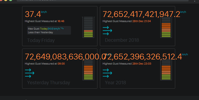

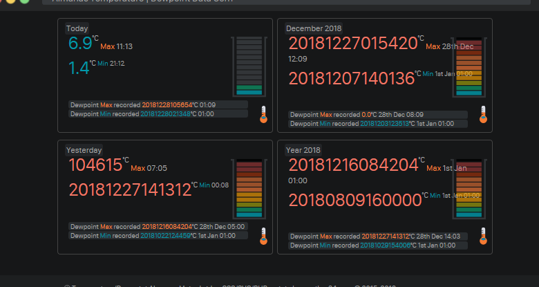

I have a Meteobridge pro since October,
I made an update of my MB at the beginning of December, since this the Template works not correctly.

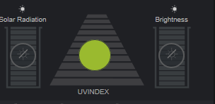

no UV, no Solar
on the Rain-Module "last Hour" is not correct
Temp. min/max of the Year
Wind Gust monthly/yearly
Almanac........
I think the new API Data and the MBrealtimeupload.txt is the problem!!
the current Release of the W34 Template is 181228_MB
the current Release of the MB pro is 3.8 ( Dec.27 2018, build 12610 ), FW1.4
Hardware: Davis Vantage 2 pro plus
thanks for your help

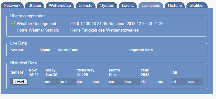

Meteobridge update 30.12.18
no live Data
Re: Interface between Meteobridge pro and Weather34 Tamplate
Please try again with just released Meteobridge update.
