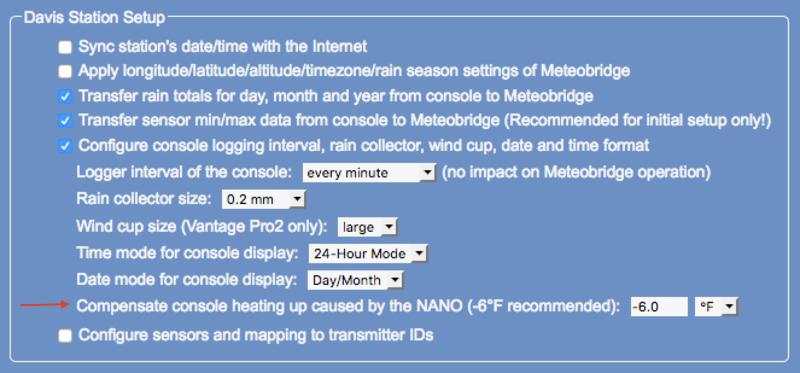

Re: Indoor heat readings increases with Nano mounted
nia wrote: Wed Aug 29, 2018 10:41 am PPS: @Admin Still it would be awesome if the console calibration Wim pointed to could be managed through the NANO web interface :wink:
When you make use of the Calibration feature shown in the picture below it is done as Wim explained. The display of the console will also adapt to this.

Sorry for resurrecting this thread, but I'm curious about something.
I see two places under station to compensate for the Nano's heating of the console (I'm using a Weather Envoy, btw).
I see the option under "Configure console logging interval, rain collector, wind cup, date and time format" and then down below as a separate item "Indoor Temp Offset:".
I've had to use both (both -8F for the Envoy), but now the Nano shows the wrong internal temp (8F low, seemingly). I had to use both because a separate program, WeatherCat, pulls from the Nano over the network, and without setting the second one, it was reporting 8F high. =/
So, what is the purpose of one over the other?
Thanks!
When you use the compensation shown in the picture above this affects all operations of the Console (display and logger read out). When you do it in the section below where all the other calibrations are done it only affects Meteobridge. Therefor, on a Davis setup I would recommend the first option.

Hi Admin,
Cool. I believe my software that was pulling over 22222 was still showing unadjusted indoor temp until I also set the second one, but i’ll try re—unsetting it and see what it does.
staze
Posts: 198
Post by staze »
admin wrote: Sat Mar 02, 2019 11:14 am When you use the compensation shown in the picture above this affects all operations of the Console (display and logger read out). When you do it in the section below where all the other calibrations are done it only affects Meteobridge. Therefor, on a Davis setup I would recommend the first option.
Hi Admin,
Seems to be working. Not sure what I was seeing before. Thanks!!
