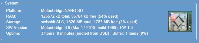

I've a Meteobridge Nano SD and when I try to do a database backup I get a "no target media found" message:
The card is recognized is meteobridge:
Any suggestions how to address this issue?
