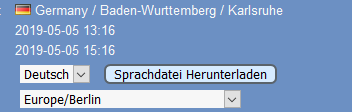

I have checked the time which is shown in the system tab with the internet time an this is correct.

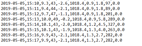

I have made a download of historical data and the time stamp here correlated with the system time, which means it is correct.

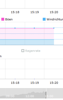

Only the presentation in the graphic section is “incorrect”. Here you can see that the last datapoint is shown at 15:20, which is ahead of time

Graph display can prolongate data a few minutes into the future. That is because it allows sensors to be off a few minutes by repeating their last data before dropping to no-data status. When you do exports you can control this with "#pragma fillgap=nn" in the export definition, where "nn" is number of seconds to fill if a gap has occurred. I don't know if that can be applied to graphs as well.
