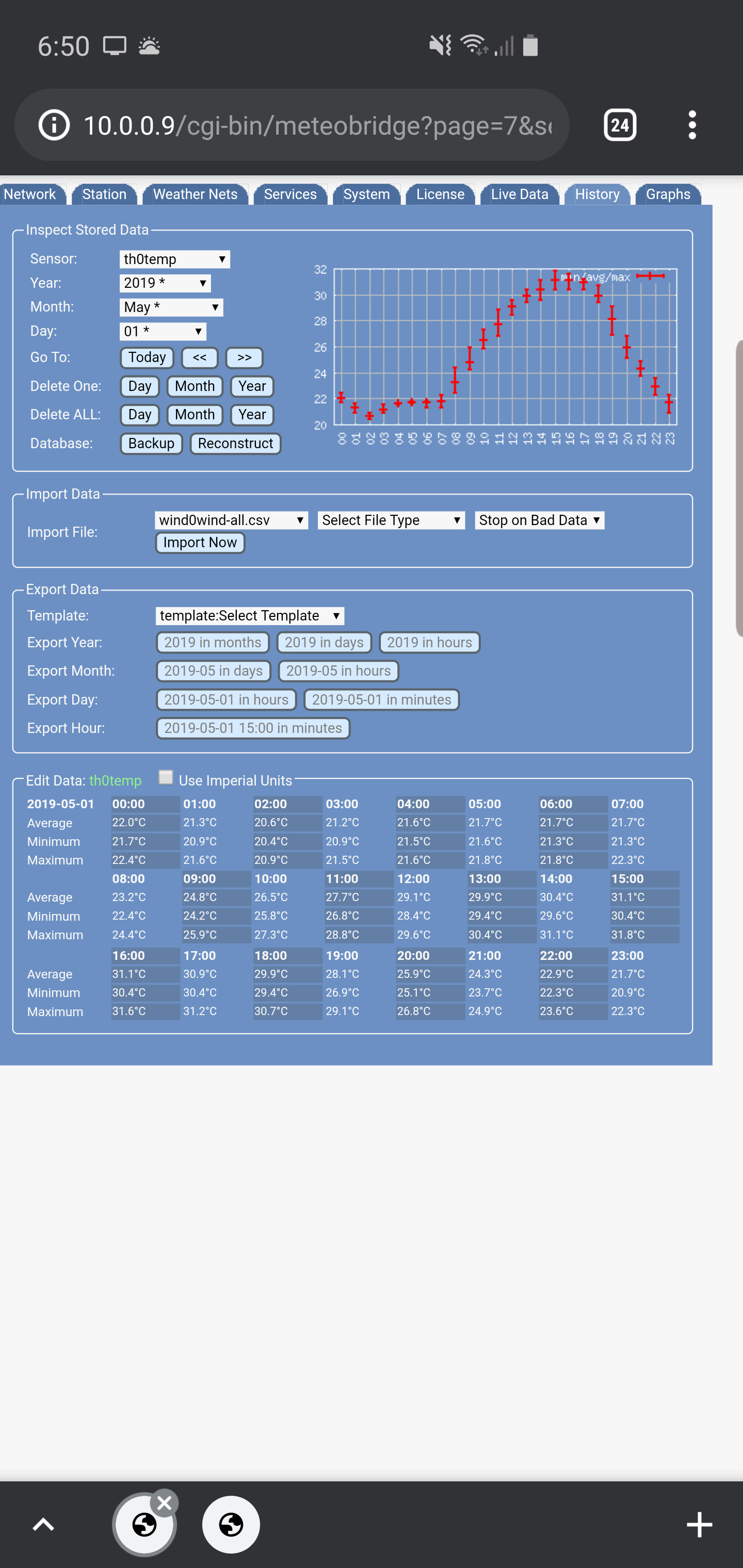

I'm on the Nano SD firmware from June 10th (2149) and still having this issue with times being way off base. Also, Live Display doesn't match the history tab (see screenshots). For instance Live Display says max outdoor temp was at 38.3C at 00:01:15 on May 1st, 2019. However the history tab says the max for that hour is 22.4C.

Just to update, this seems to be fixed for me. I noticed that daily values were updating properly but the yearly and all-time values were still messed up, so I ran the database reconstruction and now all of the values seem to be correct.

Look at my screenshot of the history tab, you can see the reconstruct button under the date selectors to the left of the chart. Takes a couple minutes to run and can see progress in the system log.
