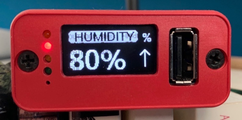

I've been running my Meteobridge PRO unit for about a year and a half now and for the last several months I have noticed burn-in on the display. I leave the RF analysis screen on at all times and you can see it ghosting behind any other screen. This is not a show stopper but I would like to get it repaired or replaced if possible. I've attached a couple of images of the burn-in I am seeing.
Any and all suggestions will be appreciated.
Robert

Even if you utilize the Display Control feature to shut it off during off hours the display will still burn-in. OLEDs look nice, but are not a great fit for informational displays.
Mine is very badly burned-in and I've been using the Display control feature since it was introduced.

I don't see a way to control the brightness at all. That might help. Yeah, burn-in seems to be a fact of life with these displays.

You probably need to loose the attitude, somebody may be able to help you if they knew what you actually required and reasons may trigger a better response, running the OLED 24/7 is a known short term failure and anything that can extend the life by reducing the requirements could extend the life considerably, won't eliminate it but will certainly reduce it.
So would scheduling the display help? Do you look at it all day and all night? Have you looked into the script variants that run/cycle the display? These won't stop burn-in over a long term but will certainly extend life.

at home my display control day ON, night OFF
the oled had been changed in October 2018
and it shows signs of burning on the screen again
