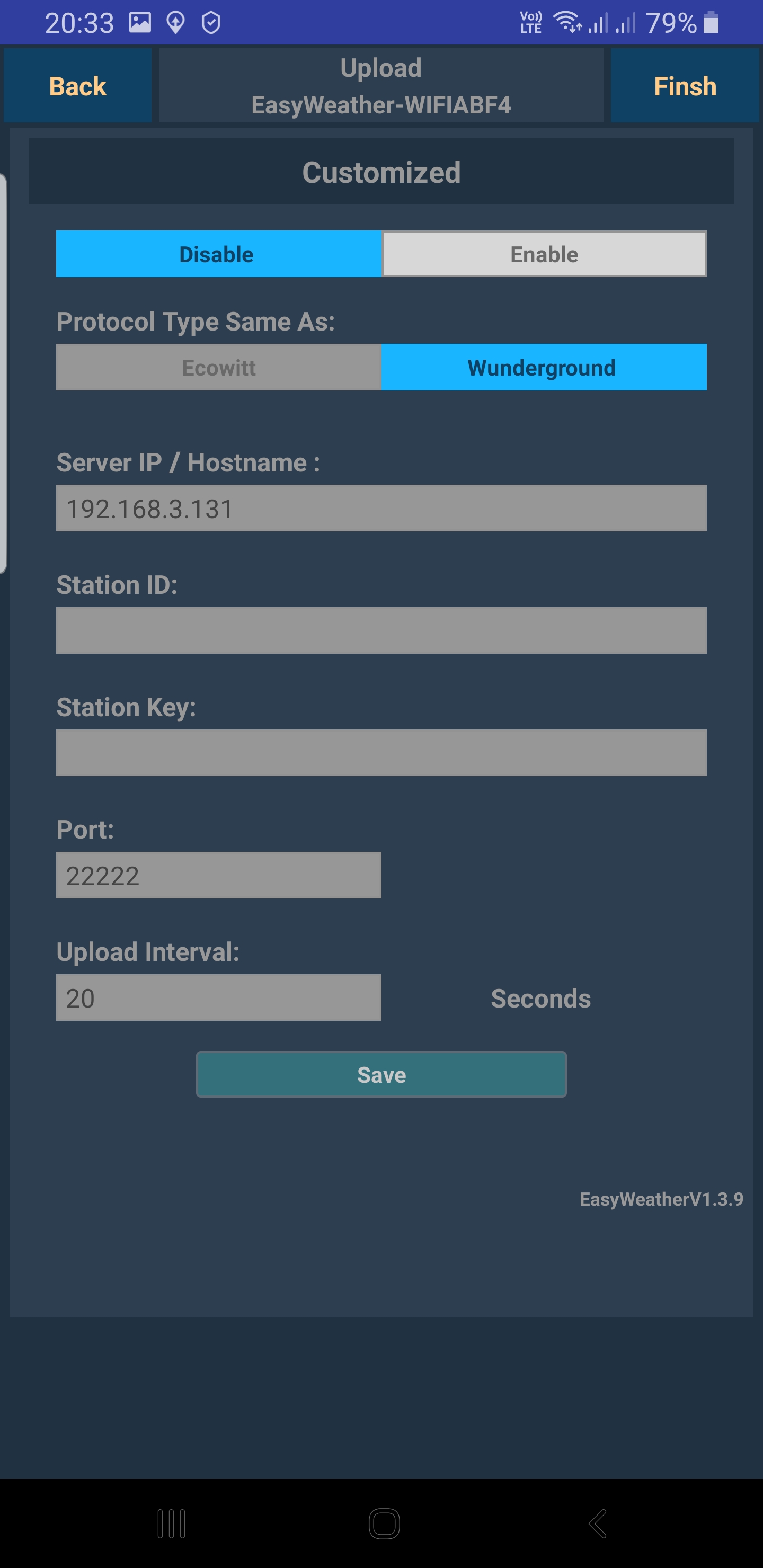

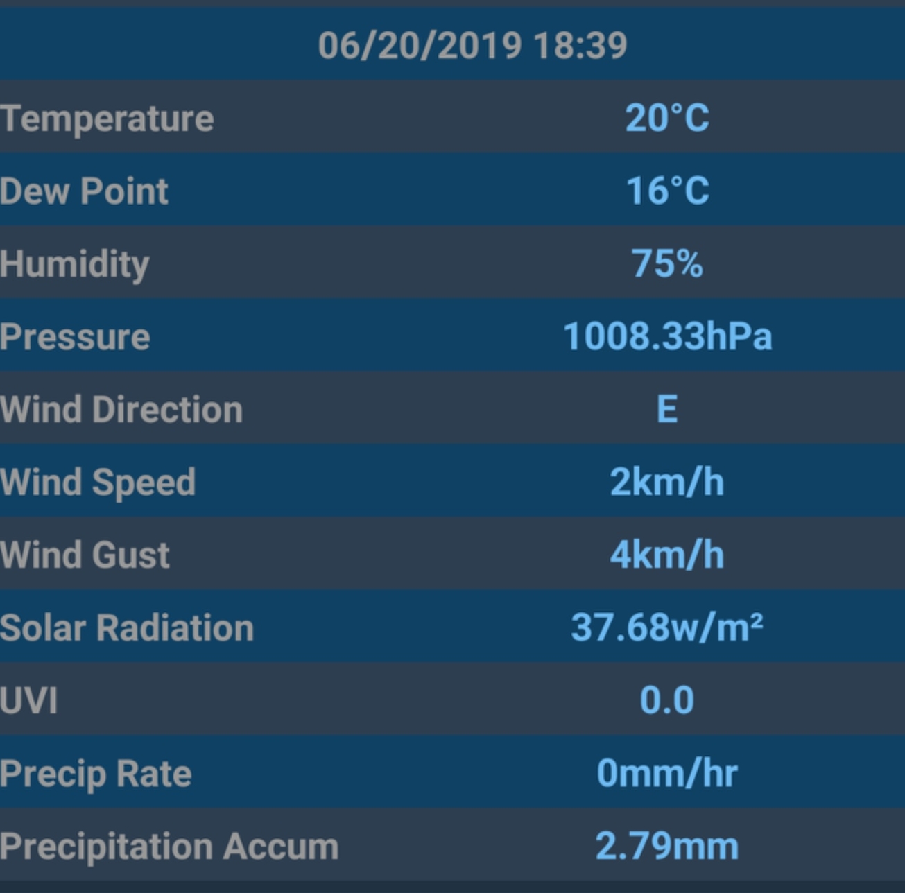

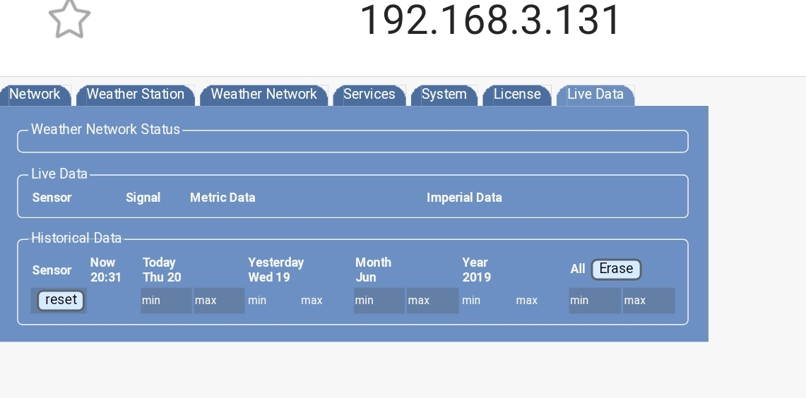

I have question regarding meteobridge compatibility..
I own MR3020, I uploaded v1.5 BIN FW, so that I test working before license buying..
But I have problem..
My data is never populate.. Is there problem regarding weather station settings, meteobridge settings or just my weather station is not compatible - in this case - is there even any compatible software..
My weather station:
http://www.ecowitt.com/weather_station/69.html
PS. To WUndeeground it's working OK.. But need to solve to work in offline case + weather station report evety 16 seconds and online service can not manage this kind of data for free (API restriction)..
The goal is to get data and to parse it to Home Assistant.. For future development I recomend MQTT protocol implementation..
My weather station:
- SmartSelect_20190620-203931_Samsung Internet.jpg (220.8 KiB) Viewed 3939 times
- SmartSelect_20190620-203755_Samsung Internet.jpg (122.61 KiB) Viewed 3939 times
- SmartSelect_20190620-203734_Gallery.jpg (253.18 KiB) Viewed 3939 times
- SmartSelect_20190620-203640_Gallery.jpg (50.42 KiB) Viewed 3939 times
- Screenshot_20190620-203400_WS View.jpg (326.5 KiB) Viewed 3939 times

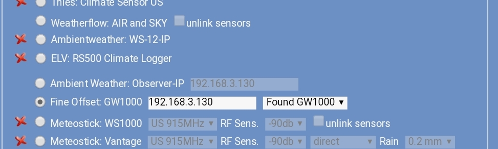

And my settings..
- SmartSelect_20190620-204628_Samsung Internet.jpg (99.22 KiB) Viewed 3938 times

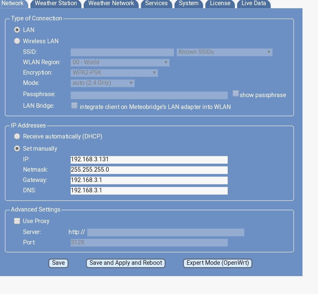

Found it... give me 2 minutes...
Re: Meteobridge compatibility
E-mail sended.. (dolenec(at)gmail.com).
If I need to open some extra ports to this IP just tell me..
You can try again.. I opened correct ports for SSH tunneling (Ubiquiti Edge router - not so simple task)
Now admin access from web is working..

Is your GW1000 on newest firmware 1.4.8?
Please remove "Server IP / Hostname" entry from "Customized" tab of your GW1000 App. This might interfere with the Meteobridge, which is trying to read data from the GW1000. The GW1000 is expected not to try to do any smart things like contacting the Meteobridge on its on. It is not working this way. Meteobridge will contact the GW1000 not vice versa.

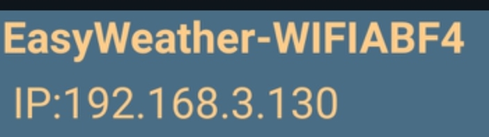

The problem is that the OP (dolenec) does not have a GW1000. They are trying to use the Meteobridge with just the WH2910C console.
I know this because in the screenshot it says EasyWeather-WIFIABF4 where a real GW1000 would say GW1000B-WIFIxxxx. The other hint is in the firmware of the console that shows it is running EasyWeather 1.3.9 instead of GW1000B_V1.4.x.
The WH2910C console does not have the JSON API that the GW1000 has. So it is not possible to use it instead of a real GW1000. The Meteobridge detects the WH2910C console on the network and it thinks it is a GW1000 because they both use the same chipset but they are running different software. I too have a WS-2000 console and the Meteobridge thinks it is a GW1000, but I point the Meteobridge to my real GW1000.
The good news is that all they need to do is buy a GW1000 and it will pick up all their sensors and then they can use the Meteobridge.
Attempting to send WU data to the Meteobridge with the Ecowitt "Customized" server settings is not supported by the Meteobridge.
