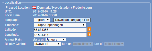

Did you set time zone on "System" tab, pressed "save" and did a reboot?

I have attached a screendump of the Localization info.
The displayed UTC and Local Time is correct.
