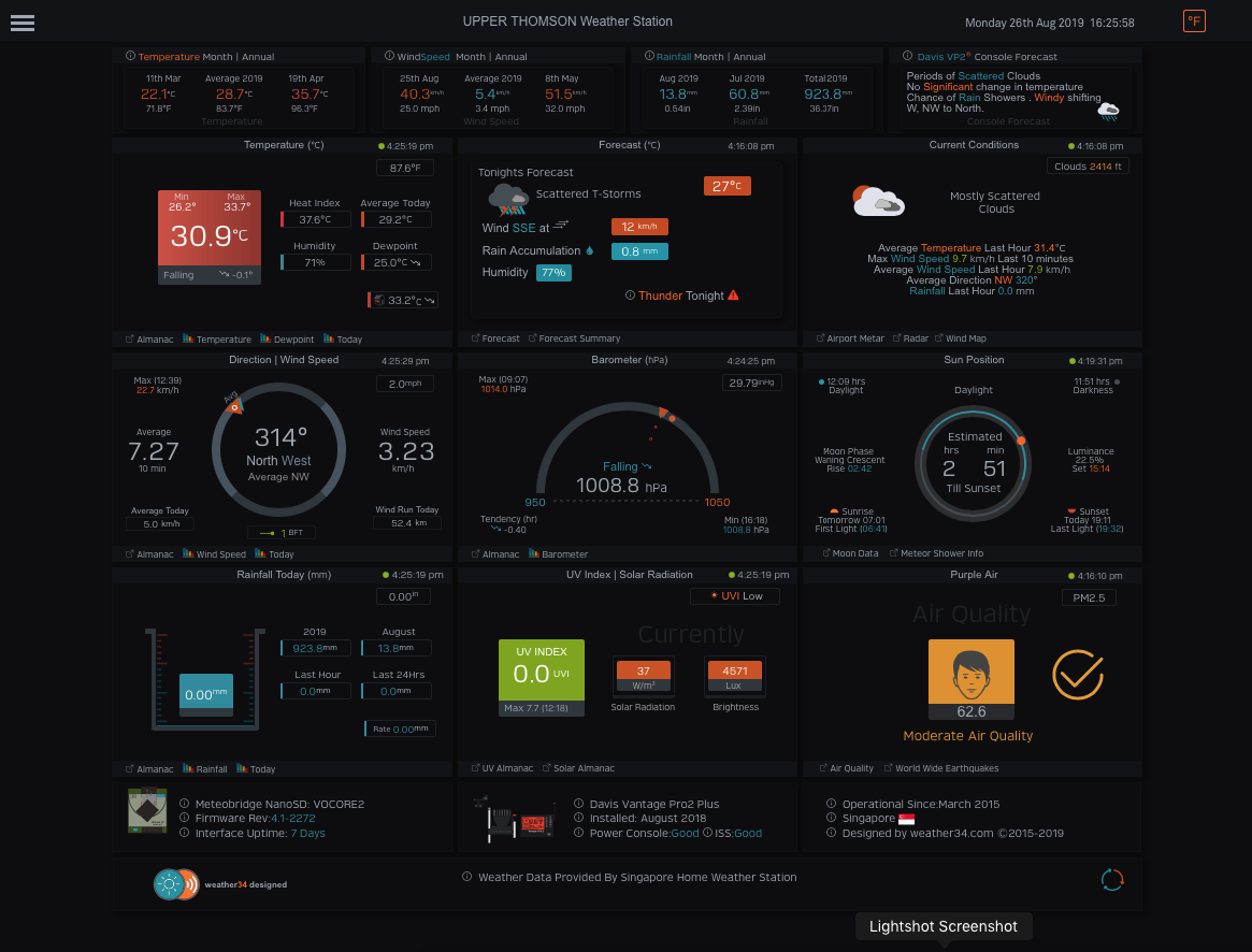

hi boris wait till end of september early october I will send you an update just need to get all the translations done and aligned and a few other minor alignments .github has become a useful tool for pushing minor changes on a regular basis .
unfortunately many users dont or are not reading the print this is primarily designed for the meteobridge NANOSD and if used with other meteobridge products like TP-LINK hubs etc it doesnt function so its 100% not suitable for anything other than NANOSD.
github reveals just how many users are trying to use it with other meteobridge products .This version does reap the benefit of using many of the NANOSD historical data methods. anyway I will email you sometime next month because there is a couple of requests from resellers of NANOSD to have the template branded but Im not sure on the legality and other boring stuff,its easy todo and doesnt change the functionality.
currently looks like this http://singaporeweather.info/?theme=dark
improvements slimmer css will be less than 100k ! , easy adapted CSS grid use , cleaner graphic appearance no blurry stuff , simple colour palette no contrasting bold colours or text , reduced languages to allow to be easily maintained and particular attention paid to not congesting too many of the modules with too much data .just takes time bit by bit each day move on to the next part..

8) That looks very good! I am already looking forward to the update. :)
