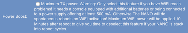

We added a "Power Boost" option for the red ribbon NANOs to make full use of the WiFi transmission power of these models in case you are operating on batteries or (better) with a 1A power supply. This option can be selected on the "network" tab of affected models. Please don't use this if your power supply does not give the needed juice, it will be stuck in reboots for sure. To give you a chance to disable this feature the full WiFi emission power is enabled after waiting 10 minutes past starting the NANO.

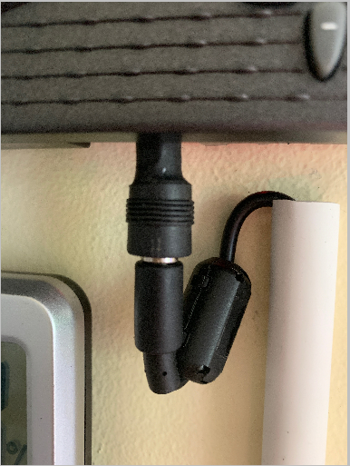

I decided to upgrade the power adapter in spite of having the black model. I ordered the following 3 items from amazon.
Power adapter - https://www.amazon.com/gp/product/B07FV ... UTF8&psc=1
5.5x2.1 -> 3.5.1.35 Adapters https://www.amazon.com/gp/product/B06XV ... UTF8&psc=1
Ferrite RFI Chokes https://www.amazon.com/gp/product/B015R ... UTF8&psc=1
The 3.5x1.35 adapter that came with the power adapter would not plug into the Vantage Pro 2 console I realized this ahead of time so I ordered the 5.5x2.1 -> 3.5x1.35 adapters. The 5.5x2.1 -> 3.5x1.35 adapter also would not plus into the Console either so I had to mill one down to fit. see attached photo.
Added the Ferrite RFI choke since Davis most likely had a reason for adding one the their power adapter.

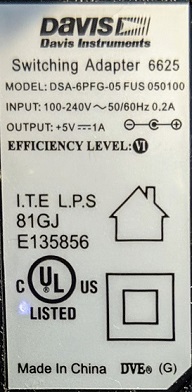

I have a Davis Vantage VUE with the attached power supply, and a MB with the Black Ribbon. I have, on occasion, experienced what seems to be wireless connection related drops and MB going offline. I realize there are other factors involved (optimal placement of device, etc) but should I (or can I) use "the more beefy supply", Amazon: https://www.amazon.com/atolla-Standard- ... y0_hl_23_6, option that Boris mentions. Thanks for any feedback :)
