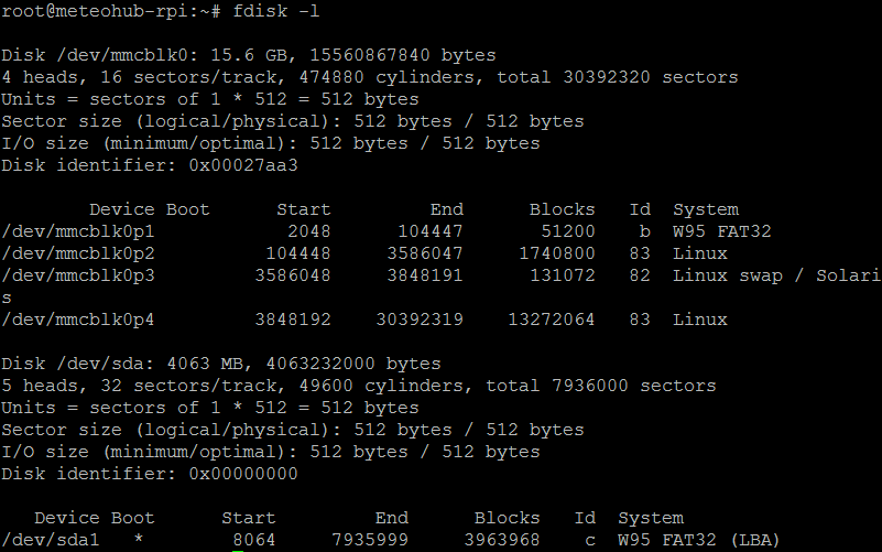

Check if the USB stick has been detected: fdisk -l
Here, the USB stick (example with 4GB capacity) appears under / dev / sda with a partition / dev / sda1. The current data partition of Meteohub can be seen under / dev / mmcblk0p4.

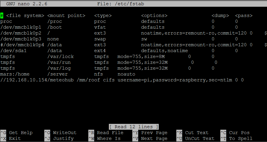

The fstab file now looks like this:
Reboot Raspberry Pi: reboot

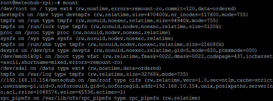

Check if the USB stick has been loaded correctly: mount
The USB stick is loaded:
/ dev / sda1 on / data type ext4 (rw, noatime, data = ordered)
