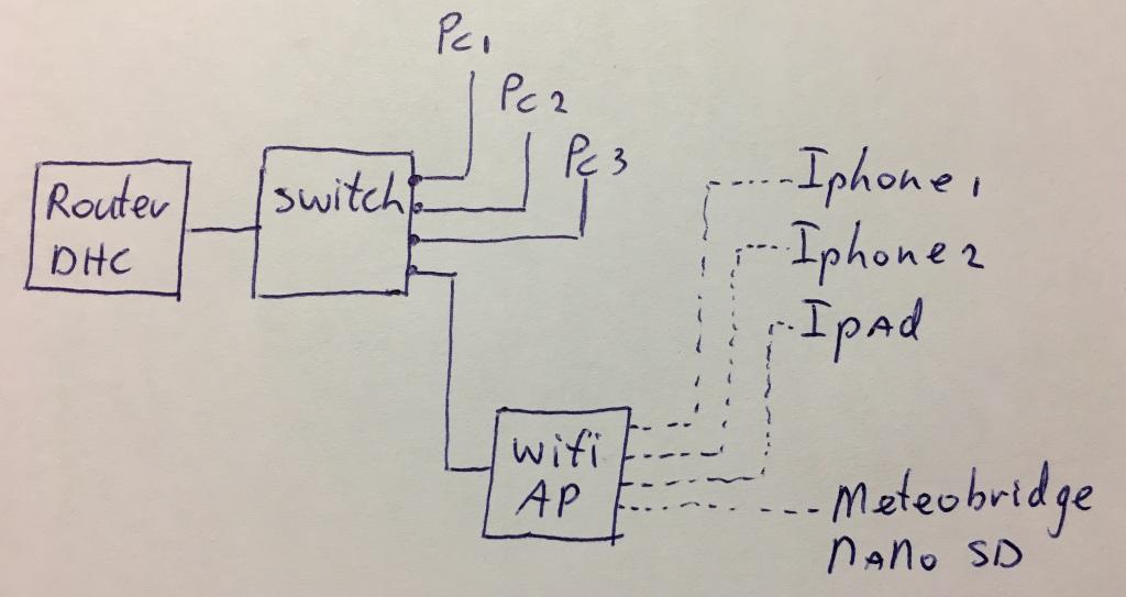

I've bought a new Nano SD for my Vantage Pro2 and have a problem connecting it to my WiFi Acces point.
Attached is a picture of the setup.
I never had an issue with the WiFi until the Nano arrived...
The Nano connects to the WiFi AP.
It can be reached using the PC1-3.
Using the iphone/Ipad, I can't reach it.
anyone got a clue what might be wrong???
WiFi AP = Engenius ECB300
I'm not using VLAN
All hardware is in same IP range 192.168.2.xxx
IP of meteobridge is fixed in router using MAC adress

Eventually I found the problem.
The WiFi AP is the problem. I put a new one in and all problems are gone.

sounds like your WAP doesnt allow Wireless devices to talk to each other. usually is a wifi setting that will allow this.
