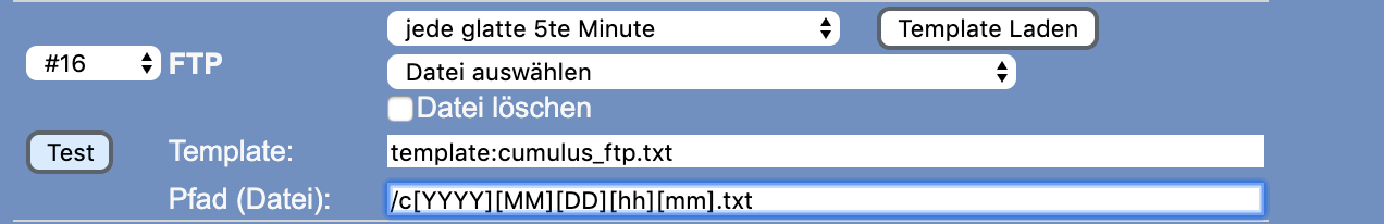

Right now I'm using following solution, that unfortunately doesn't include historical data with a resolution resolution less than an hour.
I schedule a ftp template upload every 5min to my webspace (you could choose a different schedule and vary the avg-selector)
#if#{*[th0hum-avg5.0:]>0*}#then#[DD]/[MM]/[YY],[hh]:[mm],[th0temp-avg5.1:],[th0hum-avg5.0:],[th0dew-avg5.1:],[wind0wind-avg5=mph.1:],[wind0wind-max5=mph.1:],[wind0dir-avg5.0:],[rain0rate-avg5.1:],[rain0total-daysum.1:],[thb0seapress-avg5.1:],[rain0total-yearsum.1:],,,,,,,[sol0rad-avg5.0:],,#else##[DD]/[MM]/[YY],[hh]:[mm] - no data#fi#

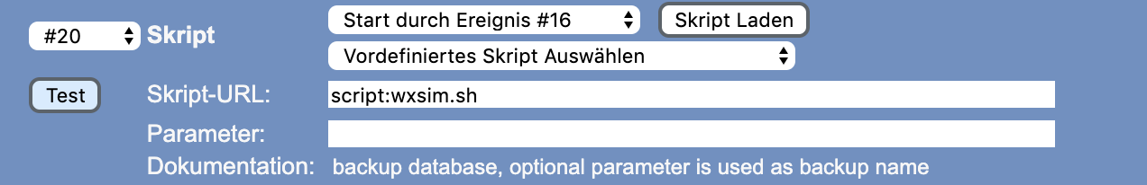

And download it with a script right after the upload to append it to a monthly log
#!/bin/sh
TARGET="/tmp/mnt/data/export/`date '+%b.%y'`log.txt"
URL="http://<...>/c`date '+%Y%m%d%H%M'`.txt"
wget -O - $URL >>$TARGET
exit 0
Not the best solution ever, especially since it requires an internet connection (I don't want to run an additional local ftp/http server), but it works for now.
