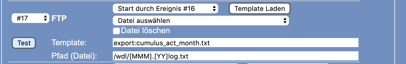

Hey,
today I noticed that [MMM] used in a filename property in events will expanded to Dec (on 29.Nov 6:20 CET)
So the filename is now Dec.19log.txt instead of Nov.19log.txt
[MM].[YY]log.txt is expanded correctly.
Bernd

Good finding! The bug is fixed with just released update.
