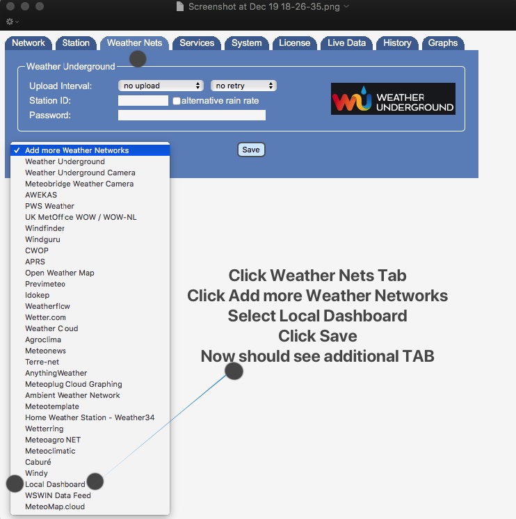

i can answer question 1 but not weather underground havent used it for years.
1. weather34 is a website template for those who have a personal web hosting i.e personal website.
alternatively if using nanosd there is an inbuilt version that does not require a personal web hosting service.
future alternative possibly late january two additional options to use a weather34 designed dashboard and not requiring any webhosting simply use your IOS iPad or Android based tablet or a touch screen phone device both apps will be free , no adverts, non monetized free for enthusiasts using nano and combined davis hardware. currently these are nigh on ready but im awaiting a low cost android tablet screen to arrive .
example of realtime use of current alternative console dashboard can be seen here http://singaporeweather.info/console/consoledavis.php and the apps will nigh on be identical .
so in short your 1st question you require a web hosting package.your domain would be what you choose when signing up for a webhosting package i.e https//ivd. xxx/mbridge/mb.php . advice avoid the low cost $1 a month hosting packages.
2nd question wunderground have a cold beer and sit back and wait to see it appears in due course .brian

sorry its brief awaiting a 2 hour flight delay and drinking the most expensive Starbucks ever
but hopefully screenshot will help you , im sure others could chime in of their around if you need more info..
