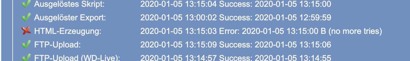

I'm seeing an error when generating HTML, but the output file seems to be correct. How could I debug this, or is there any obvious mistake ?
Screenshot 2020-01-05 at 13.15.45.png (81.32 KiB) Viewed 1519 times
Template is looking like this
#if#{*[th0hum-avg5.0:]>0*}#then#[DD]/[MM]/[YY],[hh]:[mm],[th0temp-avg5.1:],[th0hum-avg5.0:],[th0dew-avg5.1:],[wind0wind-avg5=mph.1:],[wind0wind-max5=mph.1:],[wind0dir-avg5.0:],[rain0rate-avg5.1:],[rain0total-daysum.1:],[thb0seapress-avg5.1:],[rain0total-yearsum.1:],,,,,,,[sol0rad-avg5.0:],,#else##no data - [YY][MM][DD][hh][mm] #fi#
Bernd
Re: HTML Generation
This should be solved with todays update.
