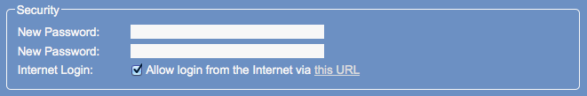

1) Go to "System" tab and set the mark at "Allow login from the Internet via this URL" and press "save and apply" button to activate this feature.
2) Copy the URL underneath the "this URL" link. The linked URL will allow you a login to your Meteobridge from the Internet. To test the feature you can click "this URL" and your Meteobridge admin interface will appear in a separate browser window.
3) You will still need the password to login remotely. When you want to grant someone else access to help solving an issue,
please change password to something like "needhelp" and tell the one intended to login remotely. Don't forget to change
back, when support has been done to have your system protected against misuse.
