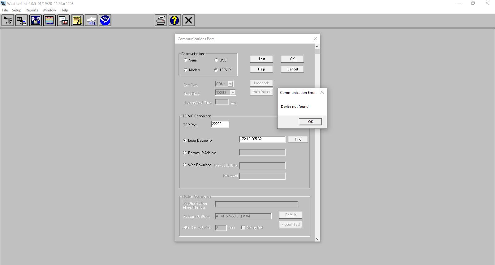

Hi, we have the WeatherBridge on are WiFi Network, we have Davis Vantage Pro2 with data logger we have the USB going to Belkin Travel 4-Port USB 2.0 Hub at is plug into the WeatherBridge, we have logged to the WeatherBridge we can see all the data from the Vantage Pro2 but when we try to connect via WeatherLink Communication TCP/IP with Port 22222 we keep getting Device not Found, we use the IP address of the WeatherBridge, any help would be appreciated.

What are you trying to connect to, WeatherBridge or the VP2? Port 22222 typically is used for a WeatherLinkIP logger and you are using USB logger.

Hi, Mattk I'm trying to connect to the VP2 via my Desktop PC we are on the same network, I wanted to use my Davis WeatherLink Software so I can save my data locally, thanks for the help

I directly connected to the router via ethernet but the weather link is still not working, I get "Device not found" I'm using the IP address of the Meteobridge I will send screenshots, I also did a Factory reset

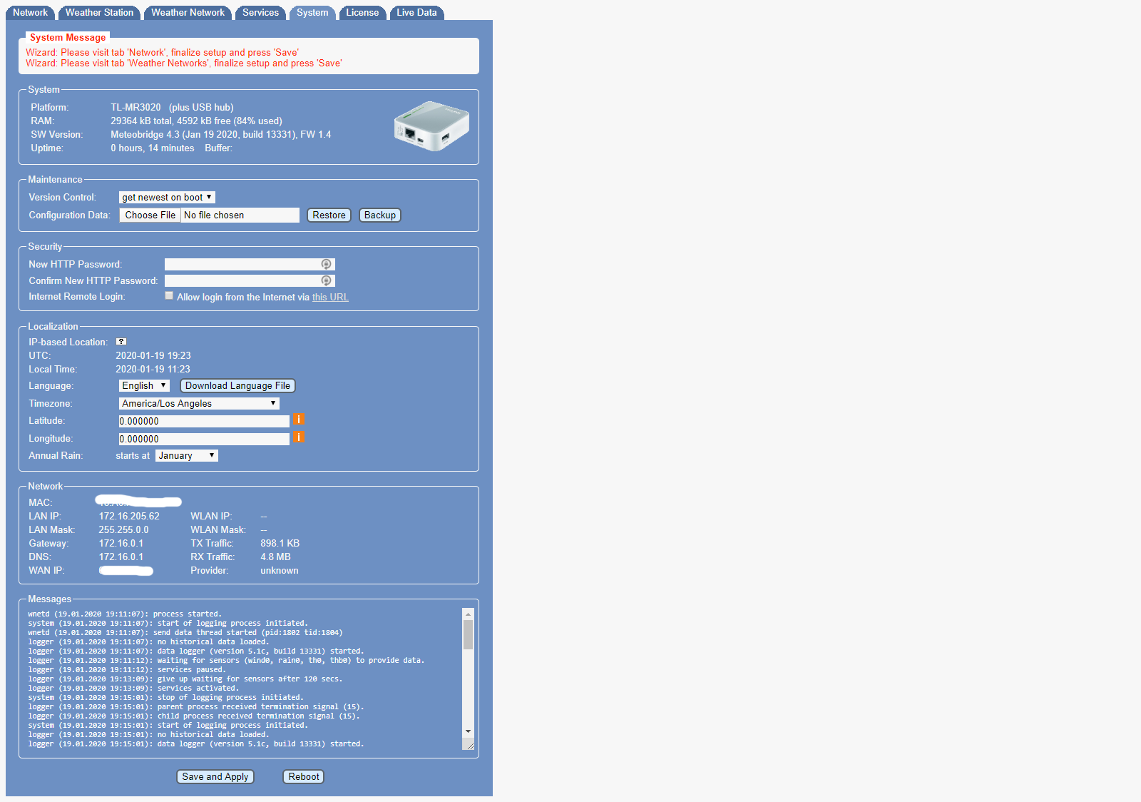

Looks like you have a class B local network. Your subnet mask is 255.255.0.0. Although there is nothing technically wrong with using a class B subnet, some stupidly configured devices/software (Davis software in this case) may have been improperly developed so that they only support a class C network (subnet mask 255.255.255.0). Now this is just an assumption on my part. But it would be worth testing on a class C network.
Is there any reason why you have a class B network? What kind of router are you using?

I'm sorry for the delay in getting back I wanted to thank everyone for the help I use the IP address meteobridge on the Remote IP Address and it worked :D
