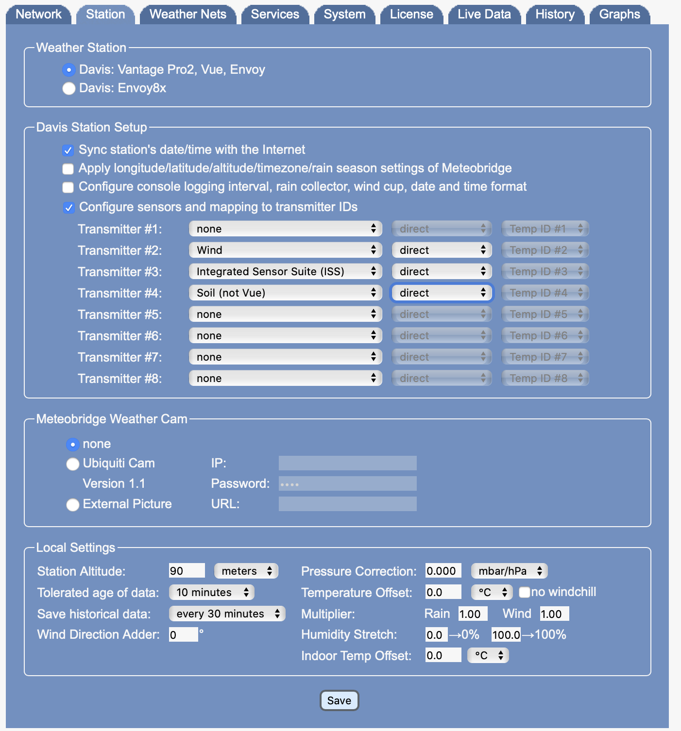

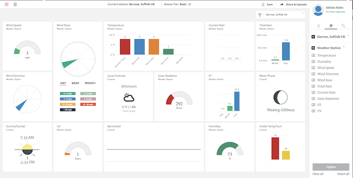

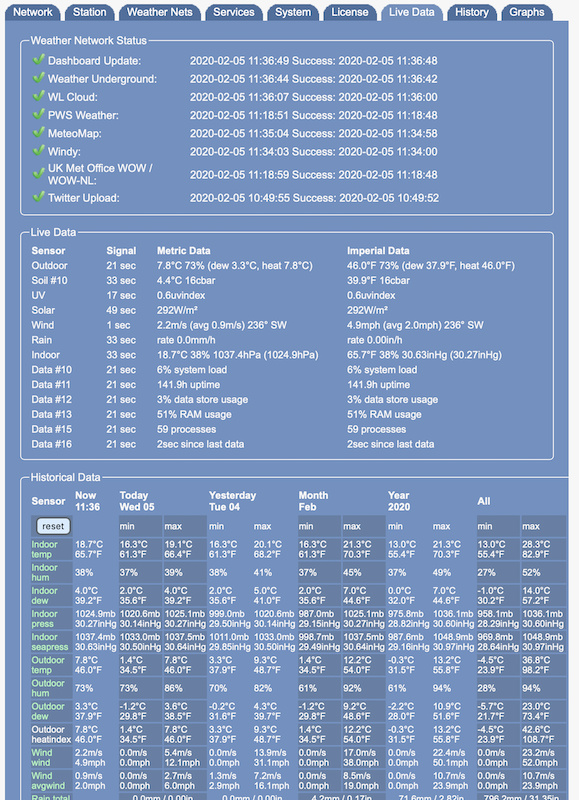

I've been using a Meteobridge NANO with a Davis Pro2 with Soil sensors for sometime and don't seem to have any Soil data being uploaded to online services. The data appears on the NANO web pages, but isn't sent to WeatherUnderground, MetOffice WoW or Davis WeatherLink.
Any thoughts would be appreciated, screen shots from the NANO and WLink below.

Yes, WeatherLink.com is run by Davis and it does fully support it. Soil moisture data also has previously been uploaded to WoW and WeatherUnderground.
WeatherSpares
Posts: 5
Joined: Wed Feb 05, 2020 1:31 pm
Re: Missing Soil data on NANO SD Cloud services
Post by WeatherSpares »
Quick update.
It looks like I was being impatient as far as Davis WeatherLink.com site. After a couple of days the soil temperature and moisture have started appearing of the main bulletin page.
