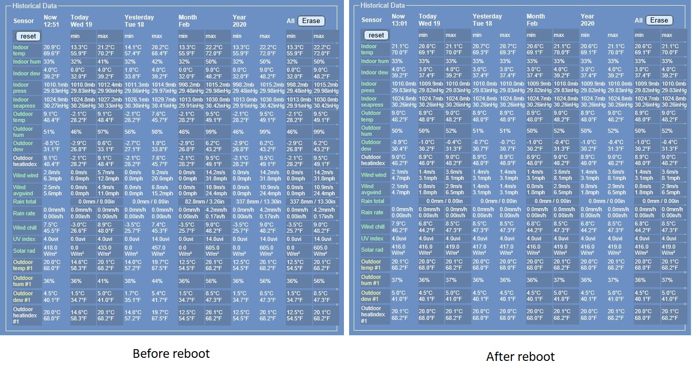

When I perform a reboot through the Meteobridge interface, all my historical data is lost.
I get the following message from the logger after the reboot: "no historical data loaded."
I have 'Tolerated age of data' set to 10 minutes.
I have 'Save historical data' set to 10 minutes on the 'Weather Station' tab.
If I change a setting and save it, I get this message from the logger 'historical data loaded (29 records).'
So, it seems the historical data is there, but it is not getting loaded after a reboot.
Is this by design, are my settings wrong, or is this a bug in the software??
Thanks!!
Ron B.

I am not using a USB stick for operation. Also, I am not using a Davis Console.
I have the Ecowitt GW1000 collecting data from a WS-2902 sensor array.
I am also using a WS-2000 console, which allows me to reconstruct my historical data.
The Meteobridge is running over ethernet, not wireless. The system works great, until I do a reboot, then all historical data is lost.
I have attached screen captures of the 'Live Data' tab before and after a reboot. Downloaded as a picture it is more readable.
The Meteobridge Wiki says that the historical data is stored on the Meteobridge server and is restored, I assume when rebooting.
It would appear that the historical data is NOT being restored when I perform a reboot.
Thank you for the reply.... It would be wonderful if we can resolve this issue!
R. Brand
R. Brand
- Live data before and after a reboot.
- Reboot Results.jpg (413.48 KiB) Viewed 5292 times

@RAbrand: can you please give me a remote login so that I can inspect this. Please send credentials to "info(at)meteobridge.com".

Okay, I have emailed you my URL and password for my Meteobridge.

Thanks for providing me a chance to test on your affected system. I found a bug related to WR902AC V3. Just released version has this fixed.

It appears that you have resolved the issue. I performed a system reboot, and my historical data was restored.
Thank you for your support!! Much appreciated!!
