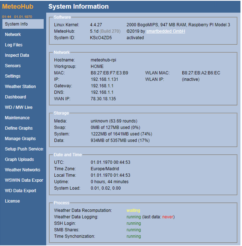

So, I have a question. As you could have read on the subject, I am having a problem with my Meteohub (Davis Vantage Vue + Raspberry Pi 3?)

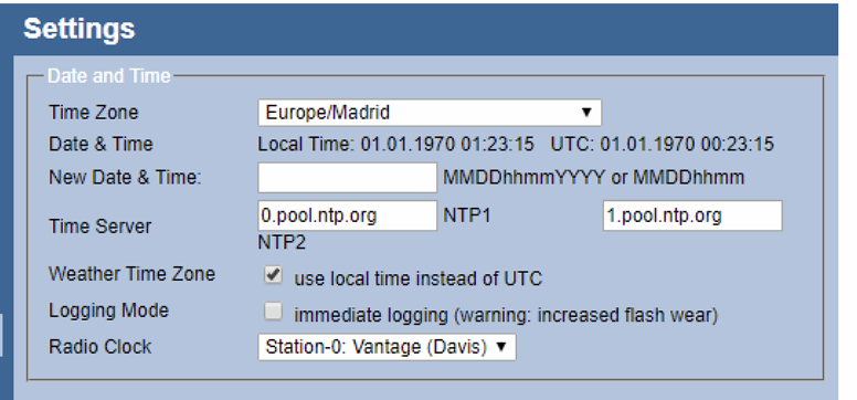

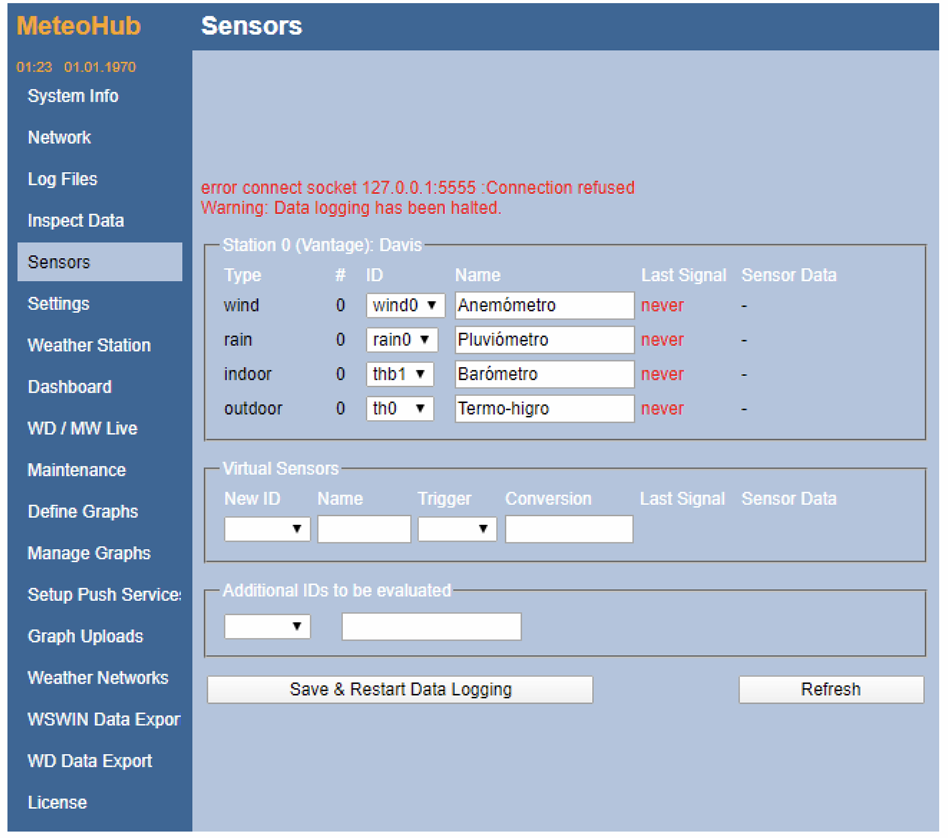

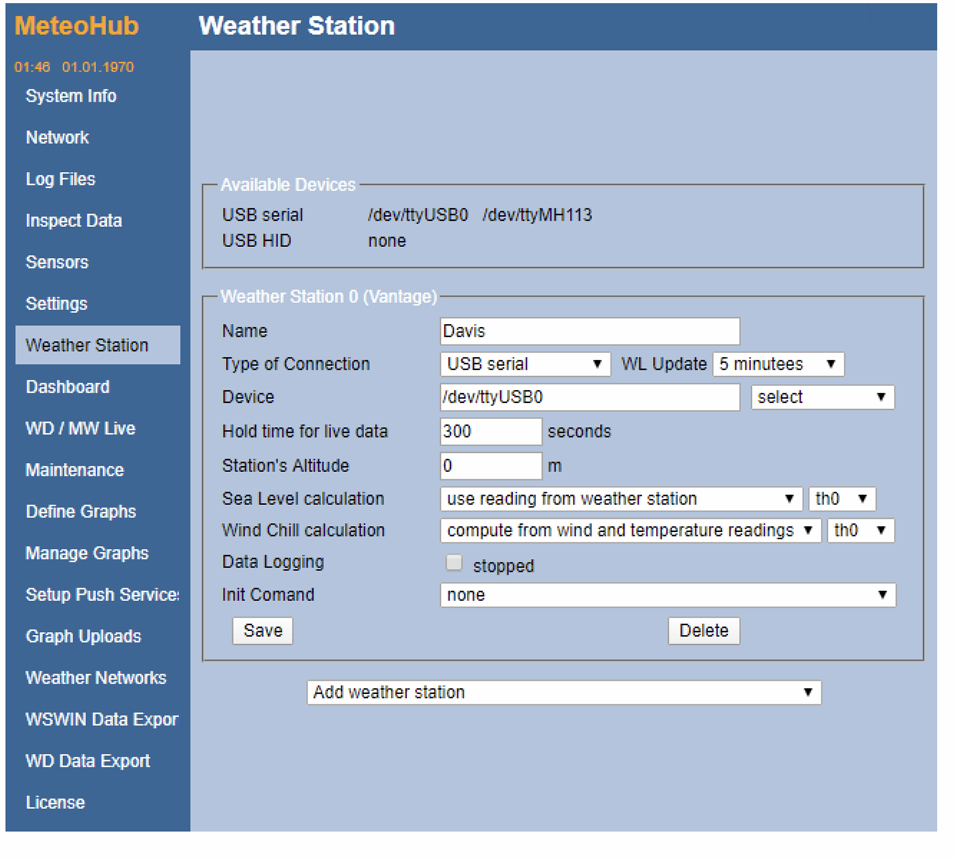

Everything started when I realised that on Saturday the station was reporting an incorrect temperature (73ºC) So I logged in the Meteohub in order to delete the files. In the meantime I stopped data logging ( on the weather station tab and I think also on the maintenance one). Something happened so I kinda lost all the monthly and yearly data for that day (then after rebooting again they all appeared).
The problem is that from that day (last Sunday) everyday at 20.00h (the time at which programmed rebooting starts) the date and time are incorrect: Jan 1st 1970 and the data collection stops. Then, in order to solve it, I have to enter manually the proper time and date so everything starts working again.
Any help please? Thanks in advance.
I am attaching some screenshots so you can see it.
