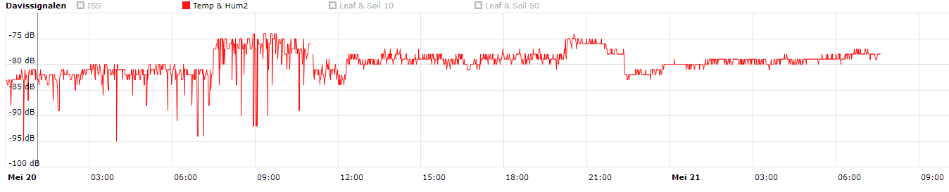

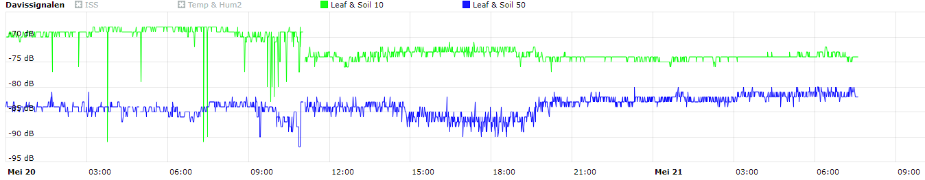

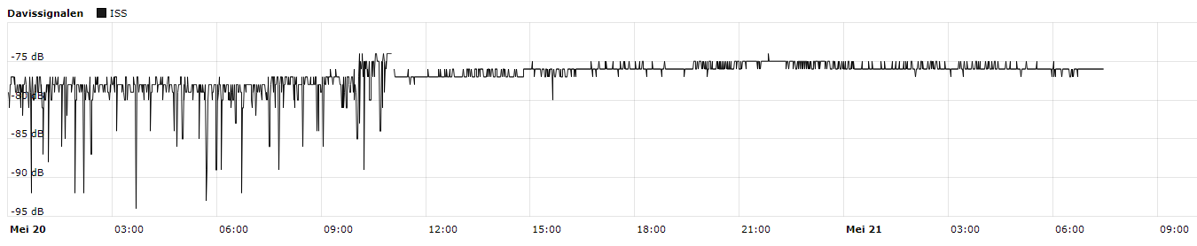

My Pro Red is no exception, signals from the ISS and 3 more stations at 20 to 30 meters frequently go down to -95 dB, while there's only a half-brick wall in between. Realizing the standard Pro Red antenna's are short, I ordered a 17 cm long 868 - 915 MHz Antenna, claiming 5dbi. meaning antenna length is now 4x the original. The MB Wiki Tutorial for the Pro Red is telling not to expect much from such change.
Attached are three plots showing the impact of the antenna change at 11:02 h.
TH2 signal.PNG (43.21 KiB) Viewed 2294 times
LS10-50 signal.PNG (51.57 KiB) Viewed 2294 times
So far the effects are obvious, the reception appears much more stable, with less drops to -95 dB. Remarkably we see a clear improvement for the ISS which is at largest distance while a nearby Leaf/Soil station (nr 50) is not changing that much.
