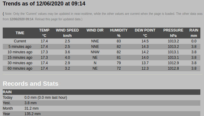

As you can see on the attached screenshot it says that it has rained 3.8 mm for 5, 10, 15, 30 and 60 min ago.
If you look at "Records and Stats":
Today: 0.0 mm - That is correct.It hasn't rained today.
Yest.: 3.8 mm - That is correct.

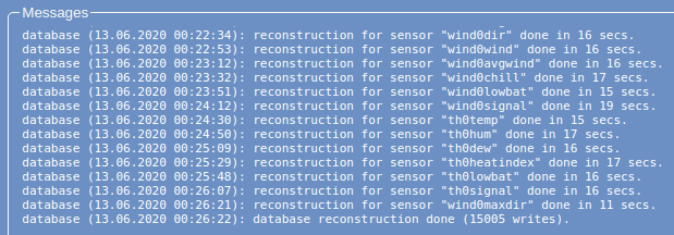

You might try pressing database "reconstruct" button on "History" tab. This will remove any inconsistencies from the database.
cphMichael
Posts: 36
Joined: Wed Oct 19, 2016 2:26 pm
Re: rain0total shows wrong data.
Post by cphMichael »
I did the database "reconstruct" but unfortunately did it not solve the problem.

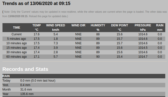

On my previous Trends screenshot the RAIN mm was 3.8
As you can see, yesterday there was another 0.4 mm of rain and now the RAIN mm says 4.2, so it seems like the Meteobridge has added the extra 0.4 mm but not cleared it in the 5, 10, 15, 30, 60 minutes ago.

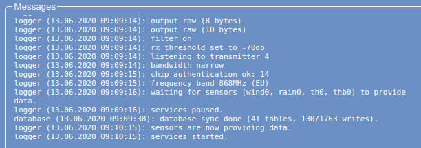

If I reboot the Meteobridge the 5, 10, 15, 30, 60 minutes ago data is reset
