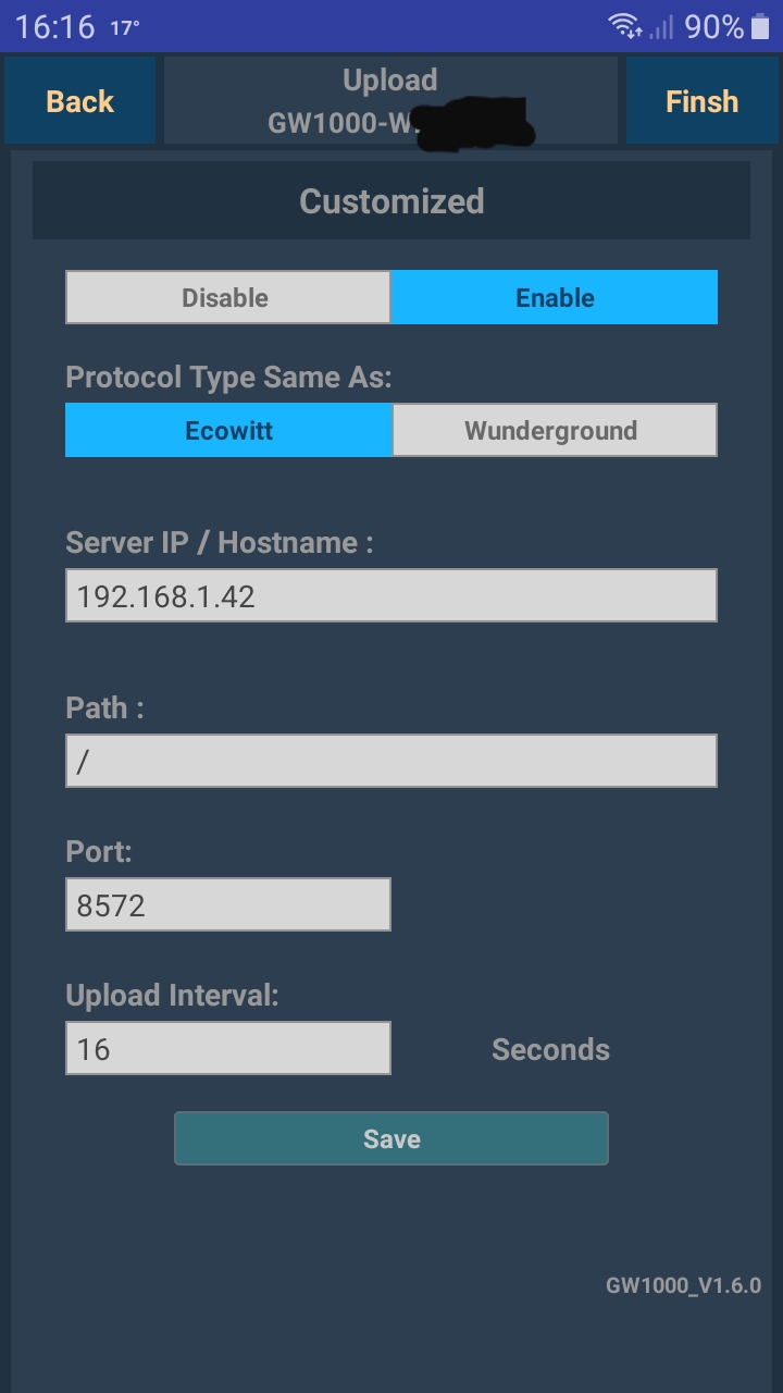

I've got an Ecowitt GW1000 that allows me to use 1 customized service. I use this to upload weather data to my android tablet on the local network. I'd like to be able to upload to more then 1 tablet on the local network. Would this be possible with Meteobridge or could it be a new feature in a future release? Option to upload to maybe 3 devices on the local network. Here's a picture of the GW1000 Customized service page to enter parameters. I'd like to have maybe 3 of these in the Meteobridge. Would it be possible?

The Meteobridge already has this capability built in. You go to the Services tab and then add an HTTP upload service type. You'll have to rebuild the WU protocol format or the Ecowitt protocol format using the MB variables.
You can add way more than 3 instances to any location you want.
When Windy first published their upload protocol, I built a custom HTTP upload to Windy using the MB (I shared it on this forum and the other one). This is before the MB gained the ability to more easily select the Windy as a destination Weather Network. It isn't that hard. Don't follow exactly this recipe as this uses variable names that Windy required. But you can use this as a proof of concept and then make changes to accommodate the WU or Ecowitt protocols.
https://www.wxforum.net/index.php?topic ... #msg376837
This is what the Ecowitt protocol looks like. It will look differently depending on which sensors you have. This will get you going though for at least the basic stuff.
POST: PASSKEY=XXXX&stationtype=GW1000B_V1.6.0&dateutc=2020-06-30+22:07:33&tempinf=81.5&humidityin=51&baromrelin=29.914&baromabsin=29.881&tempf=94.6&humidity=56&winddir=229&windspeedmph=1.79&windgustmph=2.24&maxdailygust=8.05&solarradiation=80.62&uv=0&rainratein=0.000&eventrainin=0.000&hourlyrainin=0.000&dailyrainin=0.000&weeklyrainin=0.000&monthlyrainin=9.181&yearlyrainin=22.343&totalrainin=22.343&temp1f=79.70&humidity1=48&pm25_ch1=12.9&pm25_avg_24h_ch1=14.0&wh65batt=0&batt1=0&pm25batt1=4&freq=915M&model=GW1000

http://192.168.x.x/PASSKEY=XXXX&stationtype=Meteobridge&dateutc=[YYYY]-[MM]-[DD]+[hh]:[mm]:[ss]&tempinf=[thb0temp-act=F]&humidityin=[thb0hum-act=F]

Actually I just realized that for the Ecowitt protocol it won't work. You'd have to do it with a MB script instead of HTTP service. This is because the HTTP method is GET and the Ecowitt protocol is POST. I haven't done one of those yet...but I'm sure someone else can pick up the pieces.
Meteobridge RPI | GW1000
Re: Upload to customized weather services?
Thanks galfert for the info. But I'm afraid MB scripts would be beyond me.
