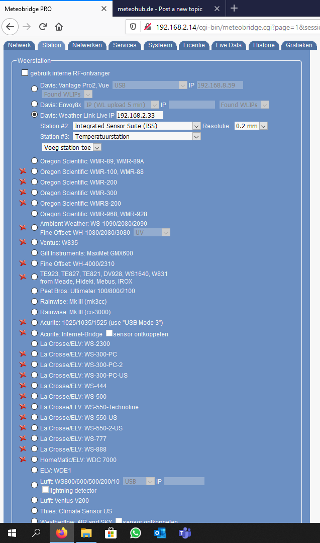

I've got a Weatherlink Live connected to my Meteobridge Pro. All working well, except my external temp sensor. I have a Davis vantage Pro 2. ISS running on ID=2, external temp sensor running on ID=3.

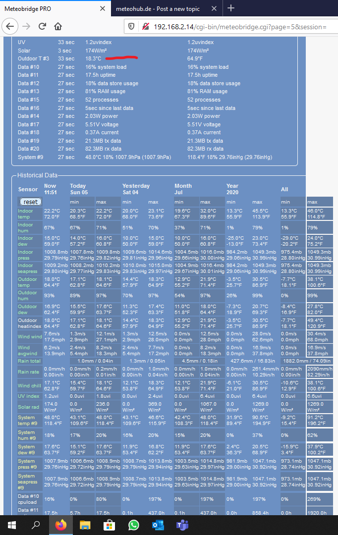

When I look at the Live data-tab, the temp sensor is displayed as 'Outdoor temp #3'. Value is correct. However, on that same tab, below, there's no Historical data on this sensor.
Reason for my question is that I use an hourly Twitter-message, with in it the value of this extra temp sensor. I cannot find the tag for it to use. I've tried every possible combinations (t0/1/2/3temp, th0/1/2/3/4/5/6/7/8temp, etc). Also on the history-tab, I cannot find the tag that displays the value of this external temp sensor.
The only clue I have, is on the Live-tab 'Outdoor temp #3'. But I cannot find the tag that belongs to it.

Should be fixed with just released update.
