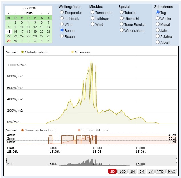

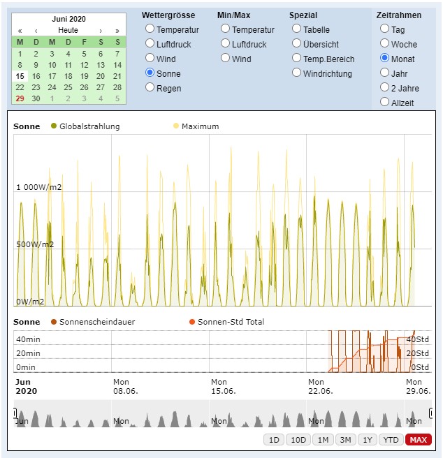

I have a virtual sensor called "data38" that I use to determine the sunshine duration. When I look at my dashboard, the data of this sensor disappears in the monthly overview on the 23 Jun 2020:
The data, however, still exists, and I see it when I change e.g. to the daily view for e.g. the 15 Jun 2020:
I have a different report on this data that shows the same effect. It only concerns data from the virtual sensor "data38" but not other sensors.
And it only concerns monthly reports. In a daily, weekly or yearly view / query, the data is there. In the monthly view / query, data older than 23 Jun 2020 does not exist. Very strange behavior.
Not sure when the issue started but I guess within the past 1-10 days. All these views worked well during the past many years and I didn't touch any of them.

Ok, problem solved by triggering a full re-calculation under "Inspect Data" in the Meteoplug UI.
