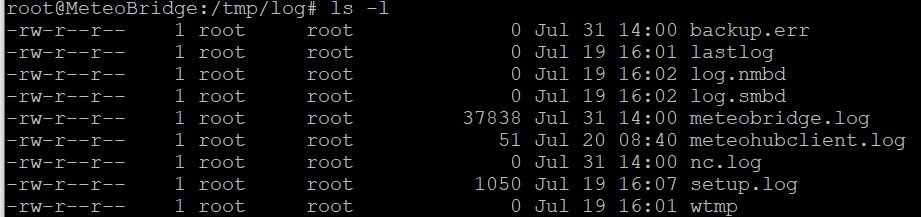

The only log I am aware of is the file meteobridge.log located in the /tmp/log directory
see picture below
MB Pro log-dir.JPG (48.12 KiB) Viewed 1153 times
Its content is what you see in the bottom windows of the system tab of the web interface.
As far as I know it gets newly created with every reboot.
