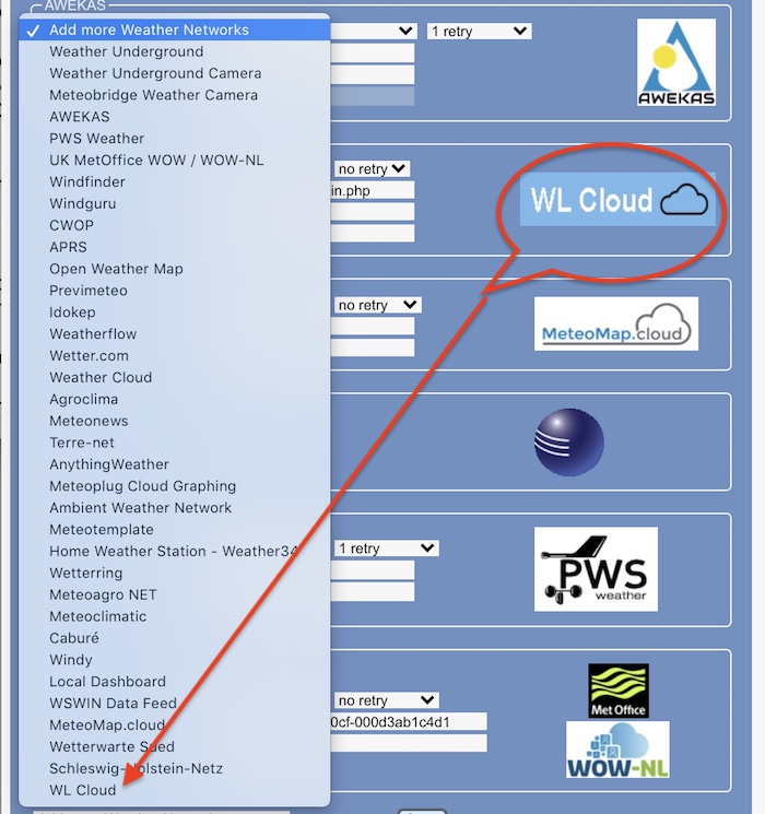

It should be at the bottom, at least it is with version 4.3, it is called WL CloudYorkshireHam wrote: Mon Aug 03, 2020 2:01 pm WL Cloud option does not show up in drop down list of add more weather networks in my MB Pro. I have version 4.4 software loaded (July 25 2020). Do I need to have my Davis USB data logger physically connected to the MB Pro and if so are there any settings to make?

WL Cloud not definitely not there on my MB Pro at v4.4 so rebooted to v4.3 and still not there. Are there any extra files I have to load or enable to get WL Cloud to show?
Re: WL Cloud not in weather net list
It is not showing up on my MB either. I do remember seeing it. Perhaps something changed and now it doesn't show up unless you have a compatible Davis logger connected....which I don't have. What I'm saying is that before even without a Davis logger the option was available....although it was impossible to make it work without the Davis logger.

I believe they do have something saying a Davis logger is required.

WL Cloud still shows in NanoSD and is called Weatherlink Cloud in the latest version release. Not showing in MBPro 4.3 or 4.4 but unsure if this is related to my hardware config or not?

I should have stated that I am using the MB Pro Red with built in RF receiver. Do I need to deselect 'Use internal RF receiver' and enable 'USB' for my Davis Vue in the station setup tab of MB. Would that then require me to plug my USB data logger into the MB before the WL Cloud option will be visible?YorkshireHam wrote: Mon Aug 03, 2020 2:01 pm WL Cloud option does not show up in drop down list of add more weather networks in my MB Pro. I have version 4.4 software loaded (July 25 2020). Do I need to have my Davis USB data logger physically connected to the MB Pro and if so are there any settings to make?
Upload to WL Cloud does need a cable connection with the Davis Console as this upload service from Davis depends on a special data packet format only a Davis console provides. Therefore, MB PRO reading data via RF directly from the sensors cannot provide this.
