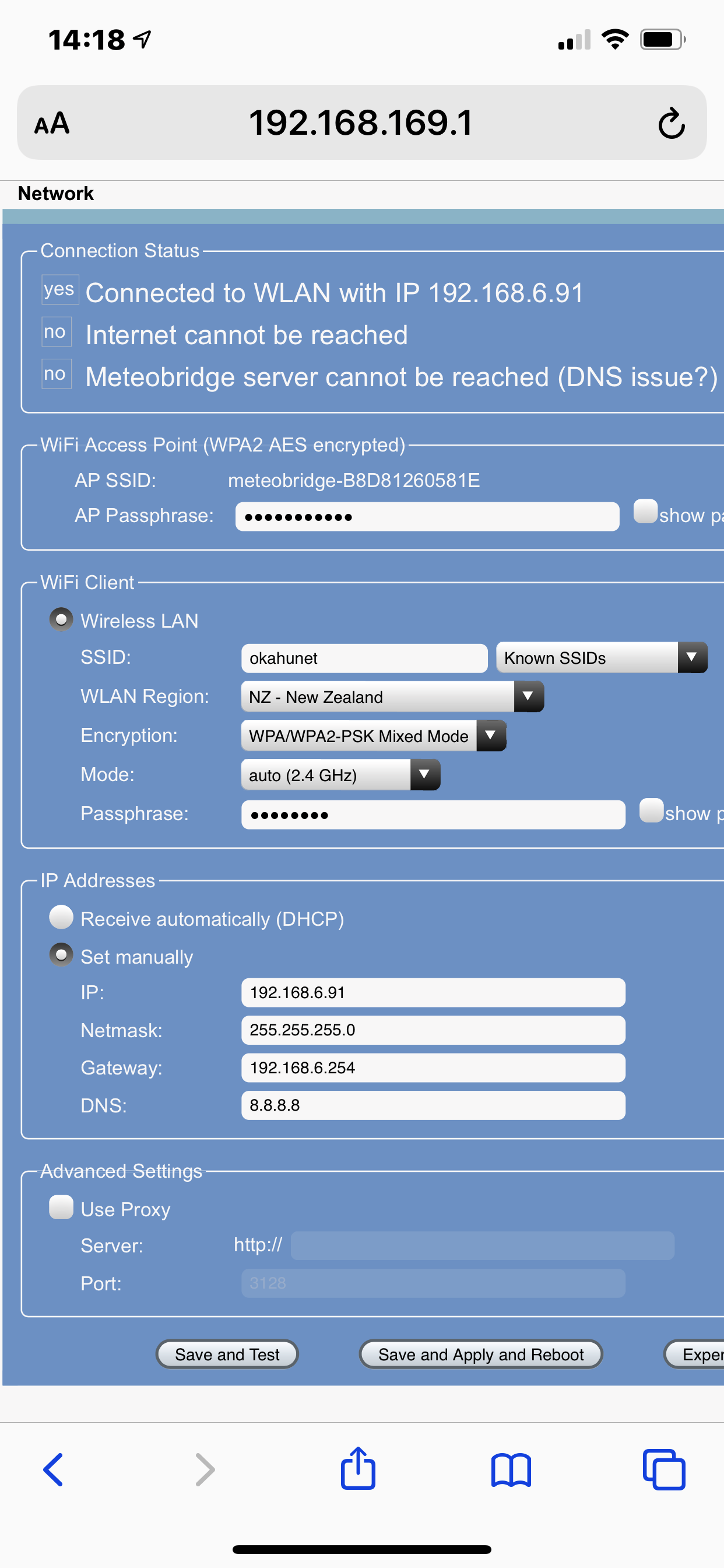

my Nano SD updated this morning
I can no longer access the web GUI , it is coming up with the local AP and i can attach to that via 192.168.169.1 , it shows the network page
Status is
Connect to WLAN at 192.168.6.91 which is where it should be , but i cannot connect to this via a PC using chrome or edge , it just times out
Interesting status also says NO internet and NO DNS ....
I tried changing it to DHCP and it no longer gets a DHCP address ...
I tried the network DNS and also google 8.8.8.8 same result
I upgraded the power supply to 5v / 1A in case , but no change , it is in a davis vue console , led is flashing on the nano
It does not answer a ping and the local AP appears to be coming up and down so maybe a boot loop ?
A problem in 4.4 ??
Status pic attached

The gateway is fine it is a firewall/router at .254
Seems odd but i think it is related to multiple Ap's , the nano can see multiple Ap's which have the same SSID which is correct and normal on this site, however it seems maybe the nano is jumping between the AP's then gives up and restablishises its own control AP , also there are 2.4ghz and 5ghz networks with the same SSID but the nano shouldn't see the 5's
I seem to have resolved it by creating a separate specific SSID just for the Nano on the closest access point , it now seems stable
