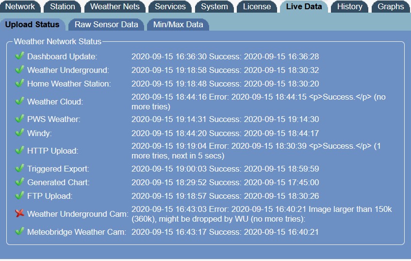

Started to run into a problem with Weather Camera function not updating (set to every 5 min). The External Picture is working fine. This is occurring on the raw image as well as the +text links. If I reboot I get a refreshed image initially but no further updates. (Actually I get one update after the reboot??) Running Meteobridge 4.4 (Sep 14 2020, build 3300), FW 1.4 . I tried to go back to version 4.3 but my backup conf is from 4.4.
I have checked all settings and they seem correct....

Clues from other posters lead me to Buffer Full.. 1000 items 100% full. After deleting all Weather Nets and services except Weather Cam, updates progressed as before.
Why would a buffer need 1000 items? Why is the buffer not deleting old data? What version did this occur so I can go back to an older version. Not fond of the multiple tab interface anyway.

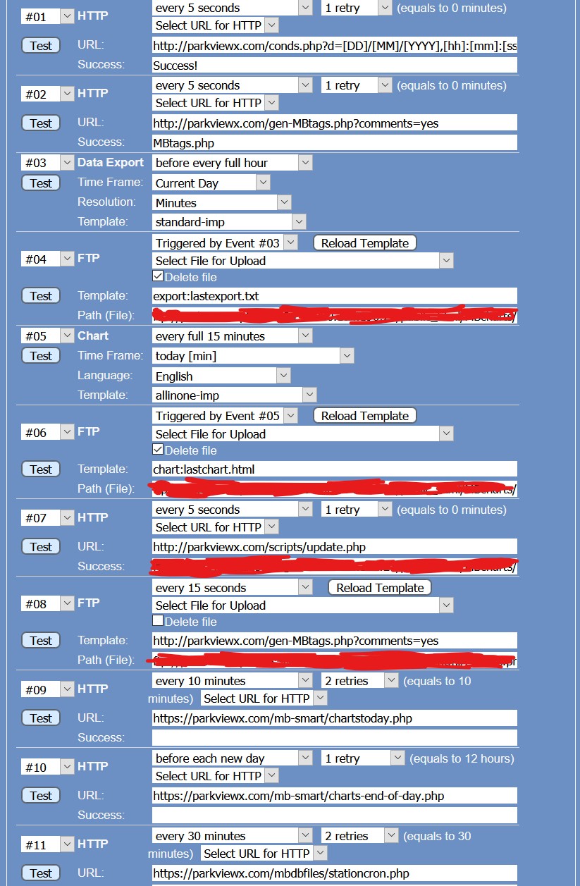

Get rid of retries and reduce frequency of sending data to any services. As long as requests are queuing up in the buffer, it will not work reliable.

Version 4.3 is funtional although buffer is at 100%. I have included my setup which indicates retries and timing information. Please let me know where you see a problem so that I may address it.

As said... I recommend to remove the retries on the 5 secs sendings and relax 5 secs to 10 secs sending. 100% buffer full is not something you should ignore. But I can just recommend, you can do what you like, but then I can't help.

Ok.. I further reduced upload retries and timing.. also switched back to must current FW.
Seems fine at this point with buffer at 1% after 18 hours...
Just can't explain why it worked fine for over a year with the original setting... Thanks
