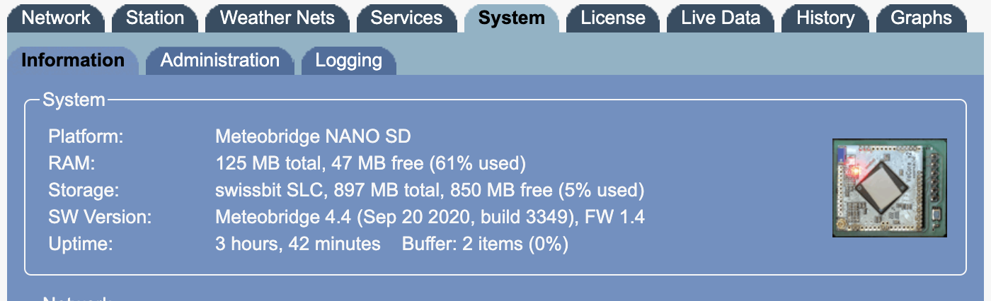

Re: Airlink
What HW platform are you on?
jasonmfarrow
Posts: 255
Re: Airlink
Post by jasonmfarrow »
Vantage Vue ISS & Console, NanoSD.

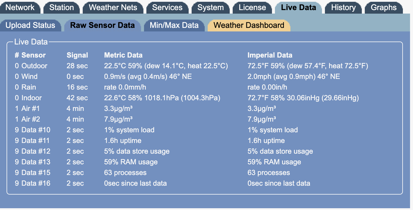

jasonmfarrow
Posts: 255
Re: Airlink
The script did indeed originate on Windows but was subsequently copied to the NanoSd and then edited by a Mac.
For all those that come hereafter the stripping of CRLF will be most efficacious. I now have good data using my preferred script.
