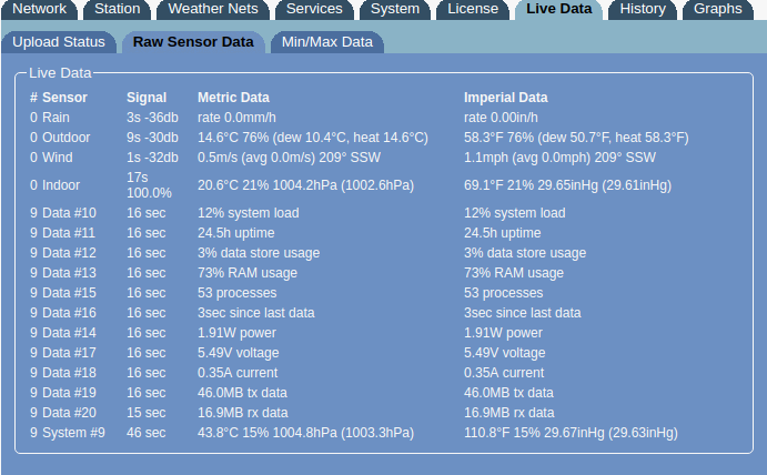

Something has changed to the Indoor hum reading.
When I look at the "Raw Sensor Data > #0 Indoor" it says 21%, but the real hum is 52%
Is that an error or am I supposed to add the thb0hum sensor to "Station > Settings" and then set an offset to +31%?
Indoore HUM is -31% off **solved**

- raw data.png (73.59 KiB) Viewed 2862 times

It has been discussed for ages, that Meteobridge PRO does not have access to the indoor temp/hum/baro sensor located inside the Davis console. Therefore, values will be different. Also Meteobridge warms up and by that more differences will show up.
If you are keen to have proper indoor values, buy an additional GW1000 or other temp station and position that inside your house. This is even better than using the Daivis indoor numbers which are also affected by a console housing heating up as well, especially when using backlight.
