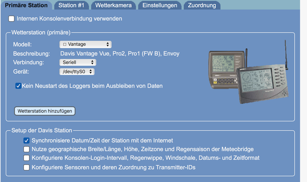

Whats going on there? Do I have to worry that the MB Nano SD will die or is it a negligible problem? In the previous SW/FW-versions (4.3) such an error never appeared. In the settings I disabled the restart of the logger in case of data loss, but this did not change anything. It seems as if the logger tries to establish a connection via port 22222, but I have no remote request from an external program to the station. (as IP logger).
Question: what means "Internen Konsolenverbindung verwenden"?

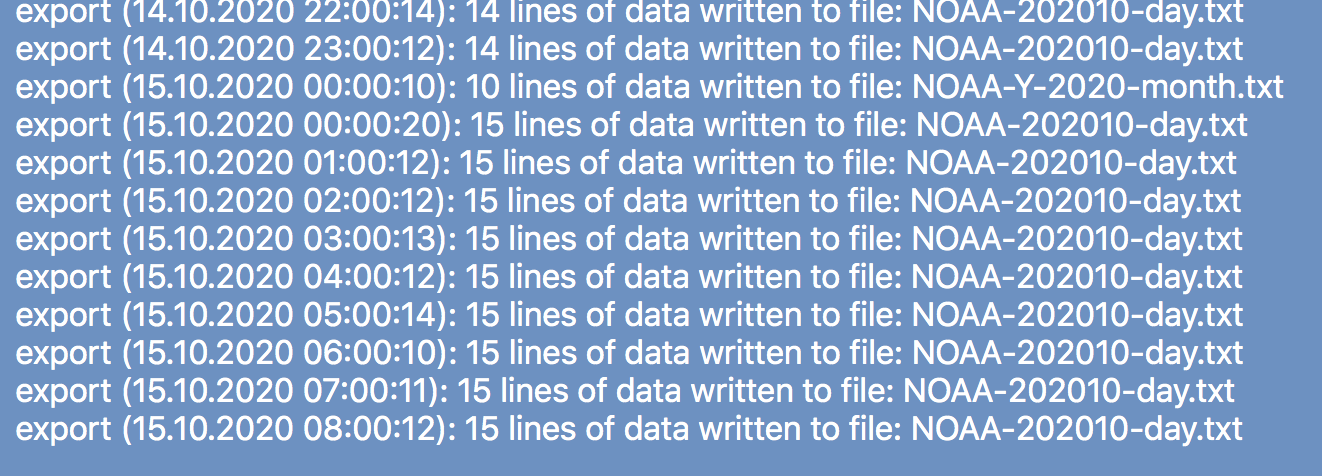

- Bildschirmfoto 2020-10-14 um 09.30.00.png (316.49 KiB) Viewed 1178 times

Edit2: The error is gone! Today the log from the MeteoBridge is clean since yersterday evenig, i do nothing..
Can't explain it to me, but it's a good one.

Having set this option tells the NANO it should use the connection to the console it is plugged into for getting data.xray77 wrote: Wed Oct 14, 2020 9:28 am Question: what means "Internen Konsolenverbindung verwenden"?
When you deselect it you can make any weatherstation that can be connected to via TCP/IP your primary weather station.
I your case I would select it, which also reduces follow on options to select from.
