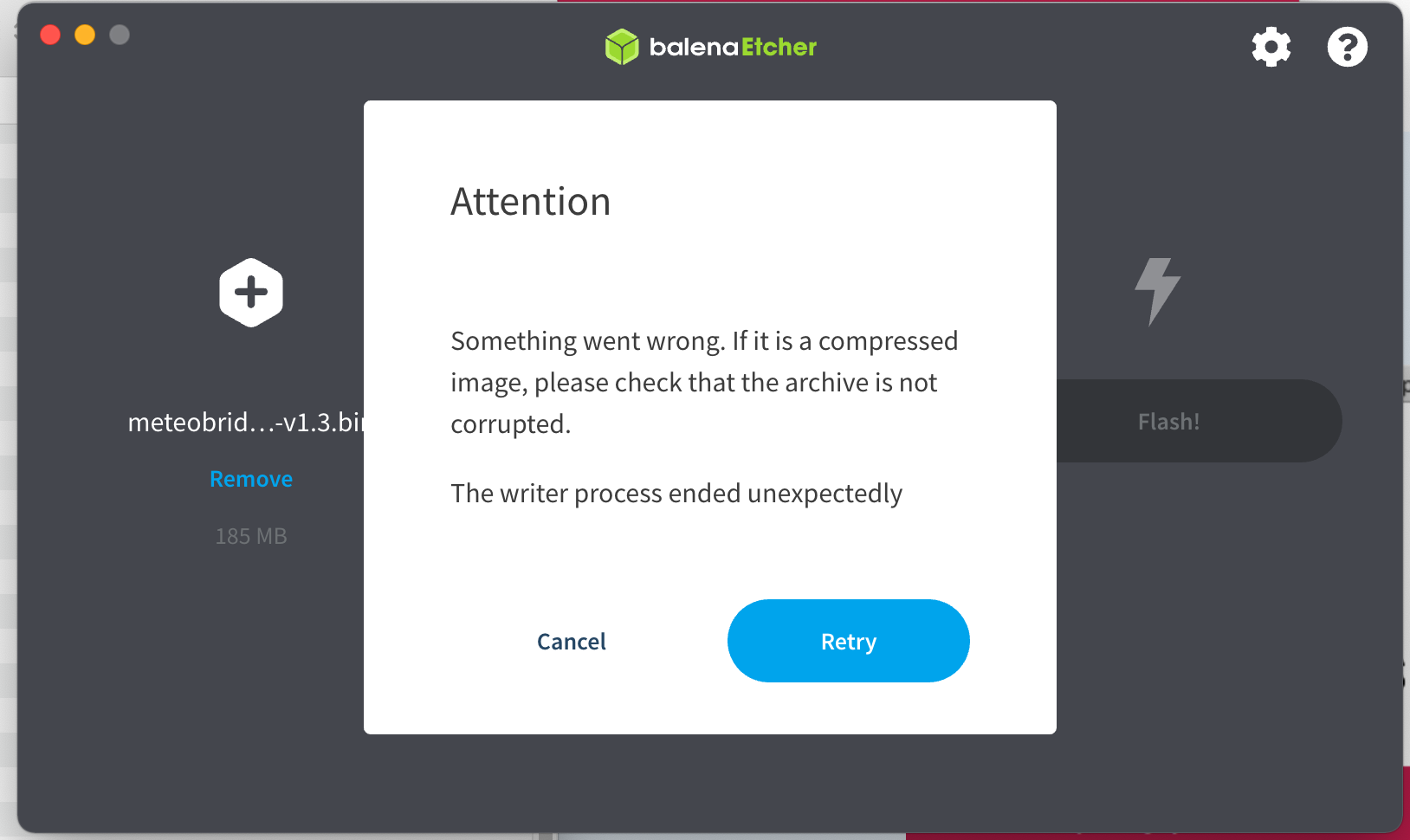

Using disk utility on mac I erased the card. Redownloaded the .bin file for Raspberry PI 3. Went back to balenaEtcher and this is the error message I get:
Screen Shot 2020-11-15 at 11.19.47 AM.png (168.7 KiB) Viewed 3745 times

I get the same error message on my Windows 10 as well

Disregard the error message I finally got it loaded but it still doesn't show up on the router. You've got me!

The difficulty you had flashing the download to your microSD card may suggest a hardware problem with the microSD card. Flash the card with a Raspbian OS image you know is good and see if it will load and run. You can also flash the downloaded bin to a non SLC microSD card and see if that will load. It will give an error message since it’s not a supported microSD card but it will load and run the software.
