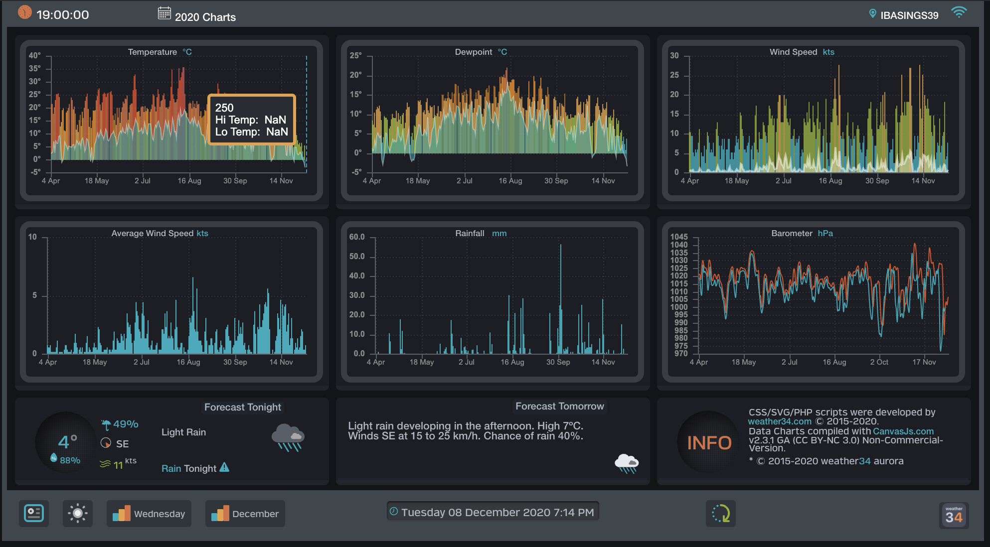

See the attached 2020 Year charts. The Temperature chart has a spurious last entry according to the hover pop-up. In the 2020.csv, and all other .csv files for that matter, there is always a blank line at the end of the file. This is usually ignored during the creation of the charts. Except for this particular chart in the year-chart page. Any idea why it's processing that last empty data point? [my data starts from 4th April so hence only 249 days of good data.]

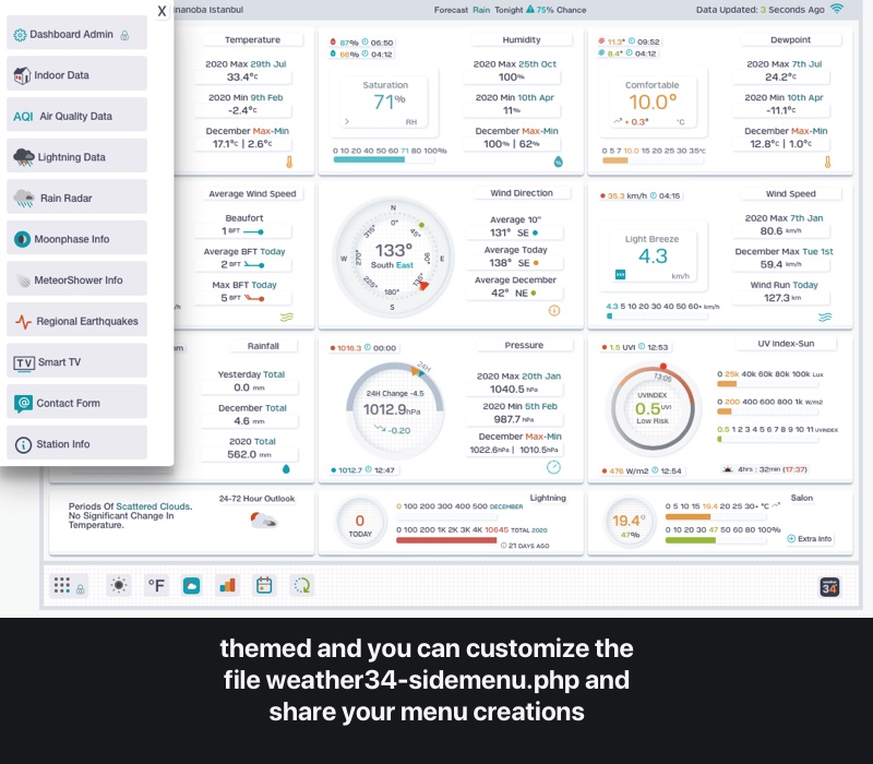

I have created a simple sidebar menu just a simple css and two lines of query.
You can customize this menu to your liking using the new file weather34-sidemenu.php and add your own links and localized radars .
Also you can share own menus for other to use by default there is one menu preset but as time goes bye if yourselves want to share the menus and have them selectable in the setup screen I am happy to add those in simply having a setup option to use for example

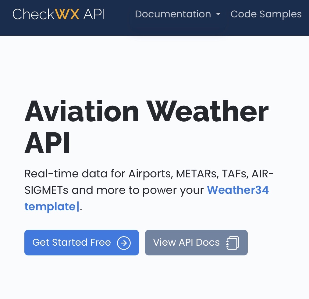

Hi Brian
I love the idea of the custom menu, its an elegant solution

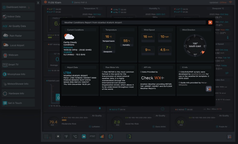

I would like to add the Metar for our local airport
How would I go about creating the link to incorporate my CheckWX Metar API KEY and would it be updated throughout the day
If not how would I get it to update
Graham
Graham

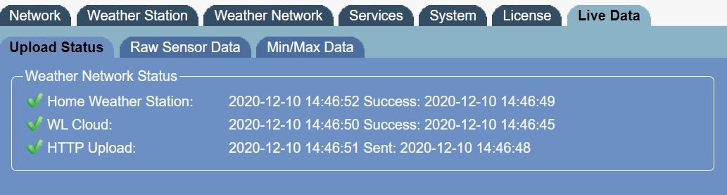

I have included the status page from Meteobridge.
Gert

@graham checkwx is an api driven format which i used to use long time ago but interest in metar data proved not so popular as the majority were not located near airports etc often 60km or more away so i moved away from that approach. myself no longer situatednear an airport i used to live 5km away by line of sight but its now an hospital complex for covid.. so i should really do something has they have been promoting weather34 template , perhaps i can knock up something as we have another 72 hour strict curfew from tomorrow night..ill let you know in due course..
Hi Brian
Thanks -that would be great
I have three or four airports within a 50 mile radius and two less than 15 miles away
Its useful to check that your weather station readings are on a par with the airports
Graham
Graham

option was added this morning i was simply able to use original 2018 popup and tweaked the design slightly to match current. you will see three options at the bottom of the setup screen . must have an API key and it obtains current nearby chosen airport according to existing forecast interval scripts. only appears in menu if option for metar is set to yes.
Hi Brian
Thanks for the latest update - awesome!!
Now have the METAR working
Graham
Graham
