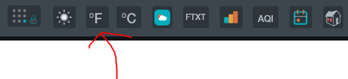

One request - is it possible to reduce the F C temperature icons to one, like you have on your site? (Selecting F brings up C). I was doing some customizing and trying to reduce the number of icons in the Legend for mobile.
Take care,
ok i can but what happens if you click F does it still show both F & C ?
On your site when you click F it shows C, Clicking C shows F. This, to me, is perfect. :D

Here is what I see on yours when viewing in Metric. When I click F it changes to Imperial and shows C.

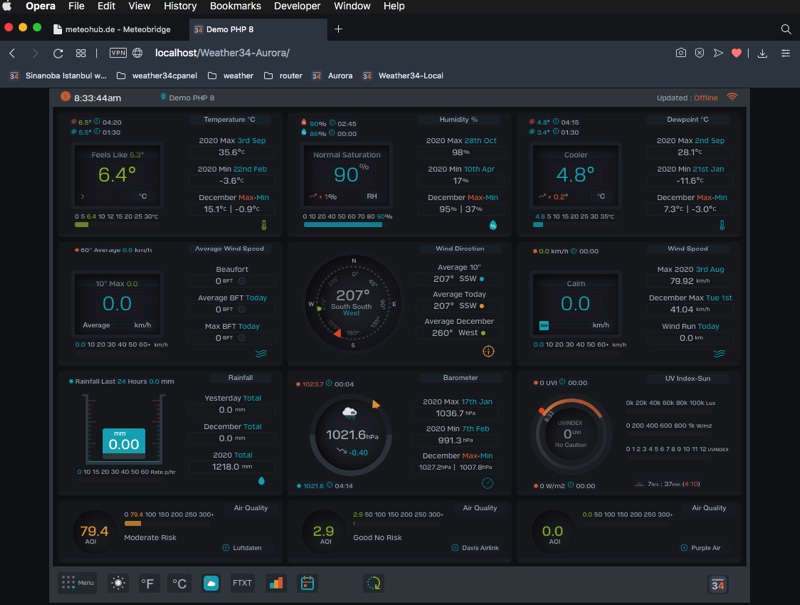

Thanks for the new Menu icon. :D Also, I figured out how to solve my issue with the F and C temperature icons both displaying simultaneously - rather than just the one needed (the opposite of the current display).
The default in the index.php was set to display both:
else if ($units==''){ // default
echo '<a href="?units=us" data-title="Imperial Units">
'.$weather34F.'</a>';
echo '<a href="?units=metric" data-title="Metric Units">
'.$weather34C.'</a>';
rather than
Which just shows the C (metric), since my Default is Imperial.
Looks like yours might work this way, as well.
