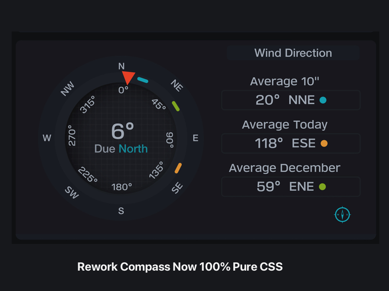

The new Direction Compass really Pops :D
thanks something i wanted todo long ago was to add more cardinals now the languages are not required less code easier to accomplish. this is just pure css no images svg etc just a simple css circle with layered borders on top of each other with some transparency or in css known as opacity..anyway that was my stay at home 72 hour project . i just pushed another GIT basically cleans up code you kind of accumulate when putting something together.

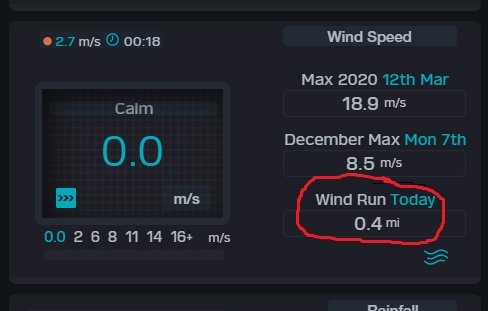

Hi
In the gustmod.php module it seems the Wind Run Today is displayed in Miles. In the setup I have chosen KM. Do you know where I can change that.
Gert

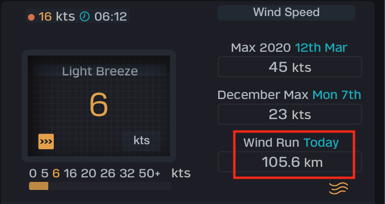

Hello Gand,
you can test following code (replace the existing code at line 113:
<?php //windrun
if ($weather["wind_units"]=='kts'){echo"<div class=tempmodulehome0-5c>". "&nbsp;".(number_format($weather["windrun34"]*1.852,1)).''.'<smalltempunit2>&nbsp;';};
if ($weather["wind_units"]=='km/h'){echo"<div class=tempmodulehome0-5c>". "&nbsp;".(number_format($weather["windrun34"],1)).''.'<smalltempunit2>&nbsp;';};
if ($weather["wind_units"]=='mph'){echo"<div class=tempmodulehome0-5c>". "&nbsp;".(number_format($weather["windrun34"],1)).''.'<smalltempunit2>&nbsp;';};
if ($weather["wind_units"]=='km/h'){echo 'km';};
if ($weather["wind_units"]=='mph'){echo 'mi';};
if ($weather["wind_units"]=='kts'){echo 'km';};?></div></div></div>
it runs for me, have select kt's (Knots) as prior unit, it should also run with the other units.
Bildschirmfoto 2020-12-17 um 09.46.24.png (79.5 KiB) Viewed 4486 times
don't forget to make a backup of the file before.. The little differences in the screenshots are due to different times of creating it.

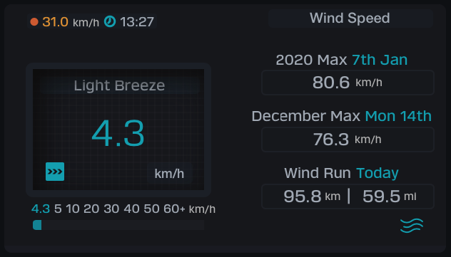

ok lets just simplify FOR EVERYONE so it delivers something of value for 99% of scenarios without getting screwed up in metrics vs mph,ms,kts,bft,kmh
so I simply removed existing formula then simplified it into two lines
used the default api position meteobridge(158) m/s rolling day average
used miles as the default formula driver then simply converted one extra output to km
so we simply have both displayed without getting lost in options and it doesn't break or change appearance of modules .
so what do you think ? screenshot below it requires no change in options, setup, css etc would just apply via the simple update
im sure some awkward git :-) gonna ask for it in meters :-)
Screenshot at Dec 17 19-00-38.png (63.07 KiB) Viewed 4449 times
Looks good to me :D
i think its a safer option for 99% as it doesnt really matter wether your using kmh,mph,ms,kts etc it simply uses the meteobridge default ms output in the formula the output is always the same .just adds a single multiplier to convert from miles to kilometers .
for the hardcore enthusiast if you want meters just simply convert(multiply) miles to meters ... 1 mile = 1609.34 meters.

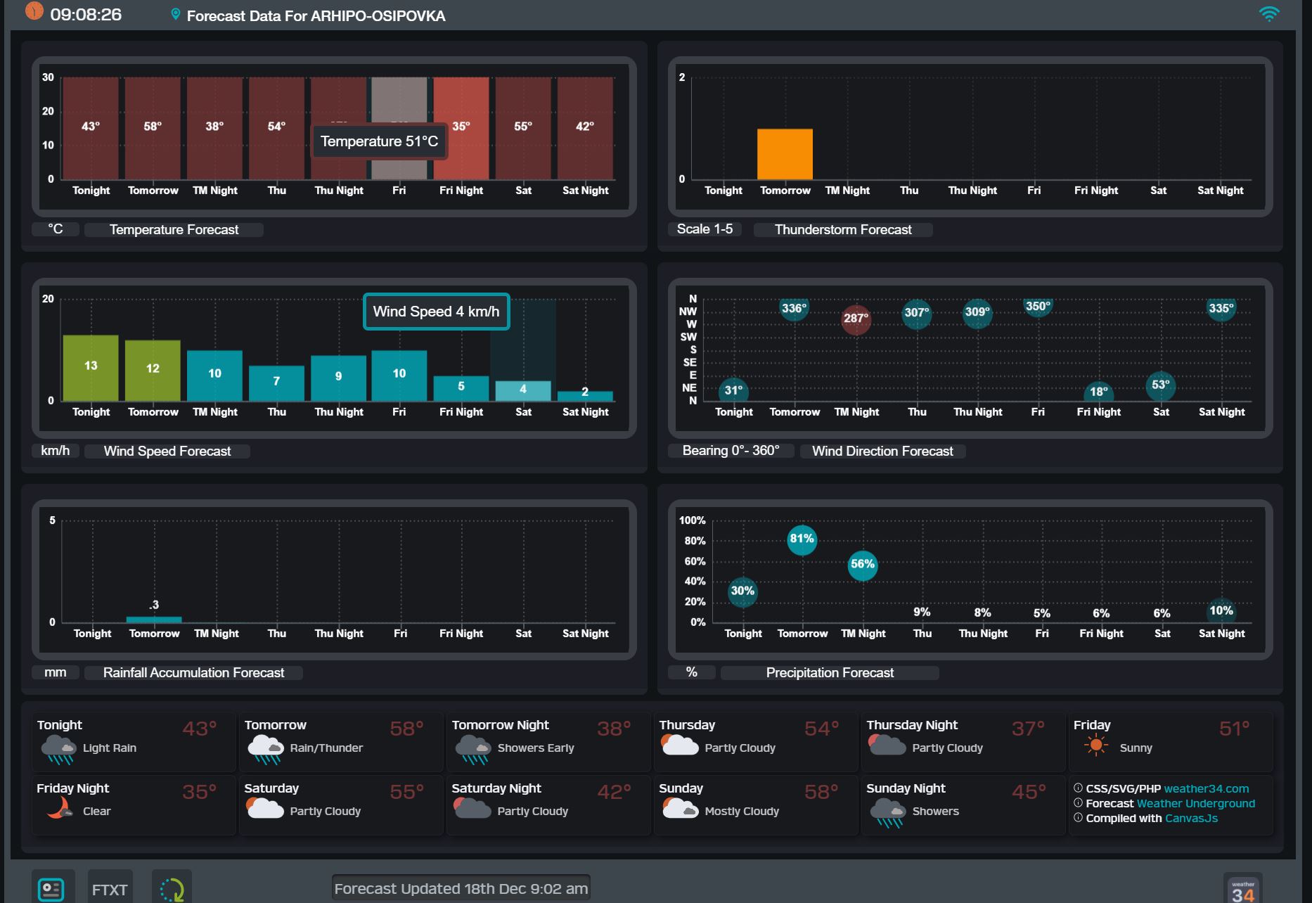

alexeysailman
Posts: 87
Post by alexeysailman »
Hi Brian! After the last update, something strange happened with the temperature forecast. I have selected the item in the settings "important set units for Weather Underground API" - Scandinavia.
