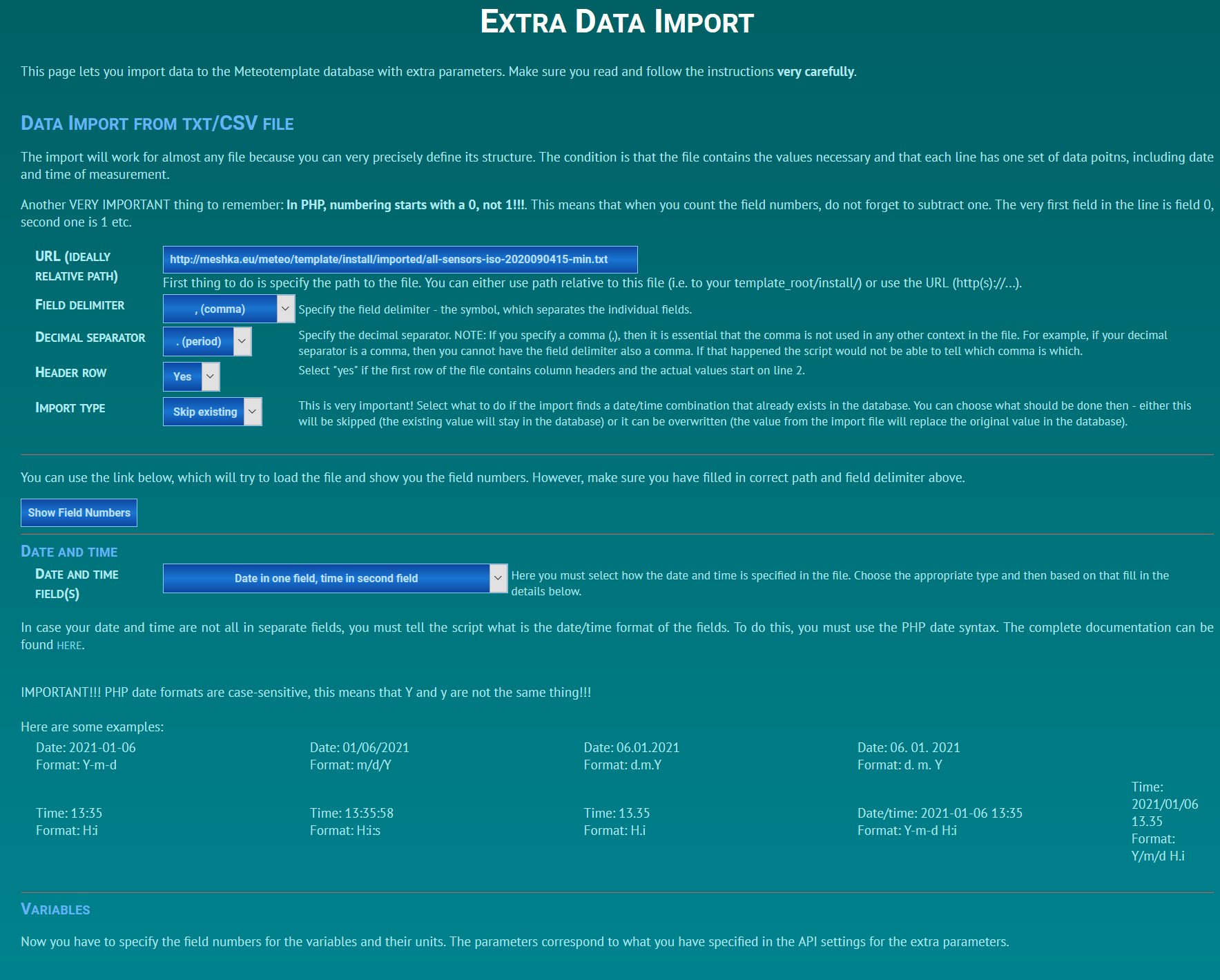

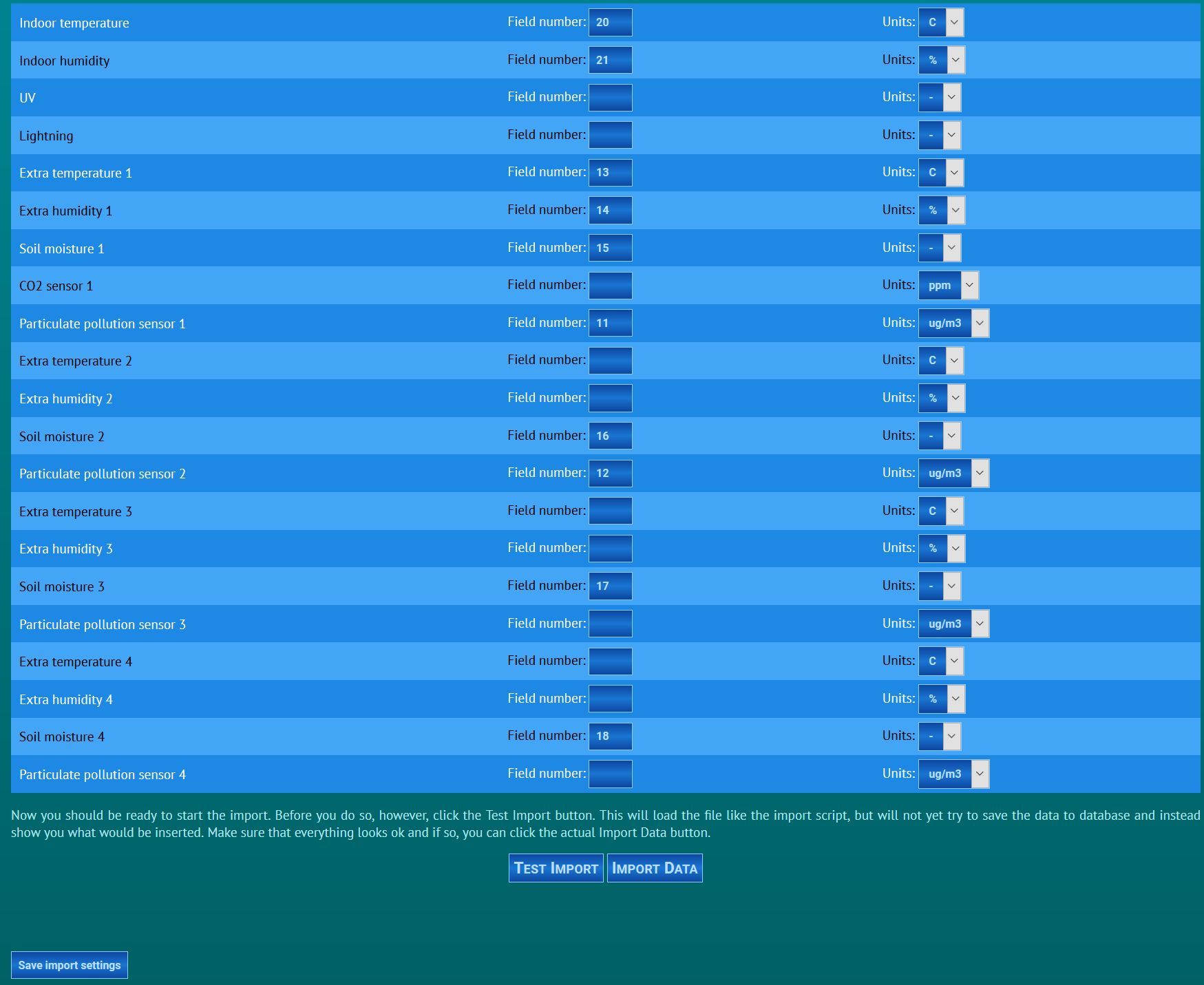

I will - I will start with my meteotemplate sql database - because there I have an easy-to-use import interface - see below:
I wish Meteobridge offered such a nice and comfortable option/interface !! Here I can use the 5-minute values as that's my storing/archiving interval there.
Jachym (the developer of Meteotemplate) did really a nice job !!
Regarding MB:
My source will be the Ecowitt.net 5 minute csv files which for Meteobridge I will have to condense to one-hour entries, as the smallest values for the Soil Moisture tables th2xhum (x=1-8) is th2xhum_hour - no minute data here.
Doing it manually in Meteobridge would be too much: 24 entries/day * 30 days = 720 entries (if you enter only the hourly average value). * 5 sensors =3,600 entries.
If you want to take high/low/average it's 3 times as many: 10,800 entries ...
It will be easier to add full, new records (table entries) than update existing ones. For this update (which is needed here for the missing SM entires) probably a SQL script will be needed. For full records MB has a procedure for CSV files. Will have to study the wiki.
It might be easier to export the data of the whole month where the SM values are missing, delete the records from the database, enrich the export with the missing SM sensor values and then import them again.
