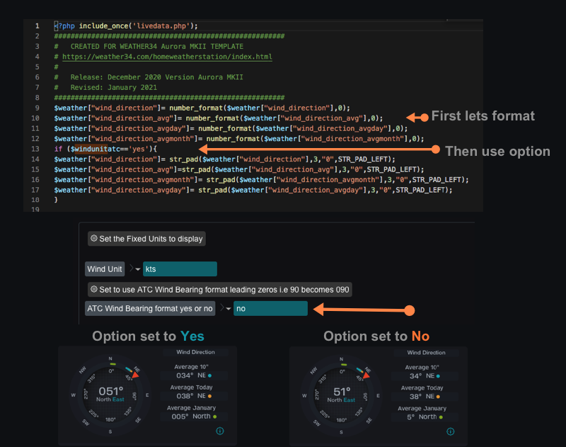

Graham,
I had a thought last night that it's not the most efficient code in directionmod.php. It only caters for adding one zero. A better fix would be to use the php str_pad() function and always pad to three digits with leading zeros:
Original code:
New code:
This works on my site https://jmfweather.uk
Original code:
<div class="windvalue1" id="windvalue"><?php echo $weather["wind_direction"],"°";?></div></div> Code: Select all
<div class="windvalue1" id="windvalue"><?php echo str_pad($weather["wind_direction"],3,"0",STR_PAD_LEFT),"°";?></div></div>Re: Weather34 Aurora Version(english supported only)

graham use the simple update for MKII ... Jason its important and smoother going forward to make things universally optional via setup screen where possible, simply build it like screenshot.
charts can be done but beware the scatter position is based on 0-360 whole numbers only is it really worth doing ? do I want to pick up the broken web sites ? NO so please think about universal options
I am all for ideas and will quite happily implement where possible but they need to be implemented optionally not fixed hardcode because every update is going to break your hard work and others too .

Brian, universality is always preferred.
It wasn't obvious from your original response to Graham's request as to whether you were going to implement this as an option. Thus I provided the simplest fix for Graham to implement at his leisure and I also warned, as did you, that it's a caveat emptor situation.
Now that you have implemented it there's no need for any user-customisation to the modules.
I agree with you that it's not worth the effort for the chart pop-ups.

* Add ATC format option for direction Ref Graham (4:24pm).
