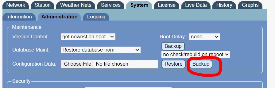

I always backup config before forcing a reboot. this is not the same a backup of database. you must backup config yourself.
I would love to see an automated task of backing up config to an SMB/FTP area on a daily/monthly basis.

You could build an event script to automate the backup of the configuration file to a remote destination or to USB drive. But this file won't change unless you are actively making changes. Seems pointless to automate the backup of a file that doesn't change. Therefore I think it is better to get into the habit of backing up the configuration file before and/or after you make changes to the configuration...I mean if you are in there making changes then save the configuration...how much trouble is that? I do this for all the multitude of networking devices that I manage ...which is extensive as it is my job to manage networks. I automate the backup of data that changes. A configuration file does not change. But either way...have it your way and automate it if you want...the Meteobridge already has everything you need to make that happen.

I have saved screen copies of all pages to my PC, and for the services also saved the http strings as text - it helps a lot when things go messy and you have to rebuild your configuration - in addition to the configuration file (which is of not too much use inside the MB - save that also on your PC)
