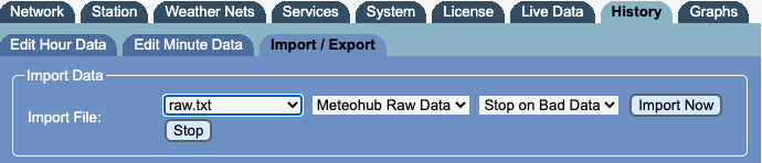

5) Goto tab "History - Import/Export" and select the file to import and "Meteohub Raw Data" as file type. Then press "Import Now" to start the process.

6) Inspect on "System - Logging" tab that import has been started. Meteobridge will pause import process every few minutes for a while to unlock database for normal operation. Percentage of completion is displayed. When you have "per minute" storage selected it will really take time. Expect 30 minutes for a month of data. But as this is done in background, you shouldn't care too much.
7) When "System - Logging" tab tells you that import is done, you can delete the imported file, copy the next raw data file to the Meteobridge "import" folder and start over at step 5) until all imports are done.
