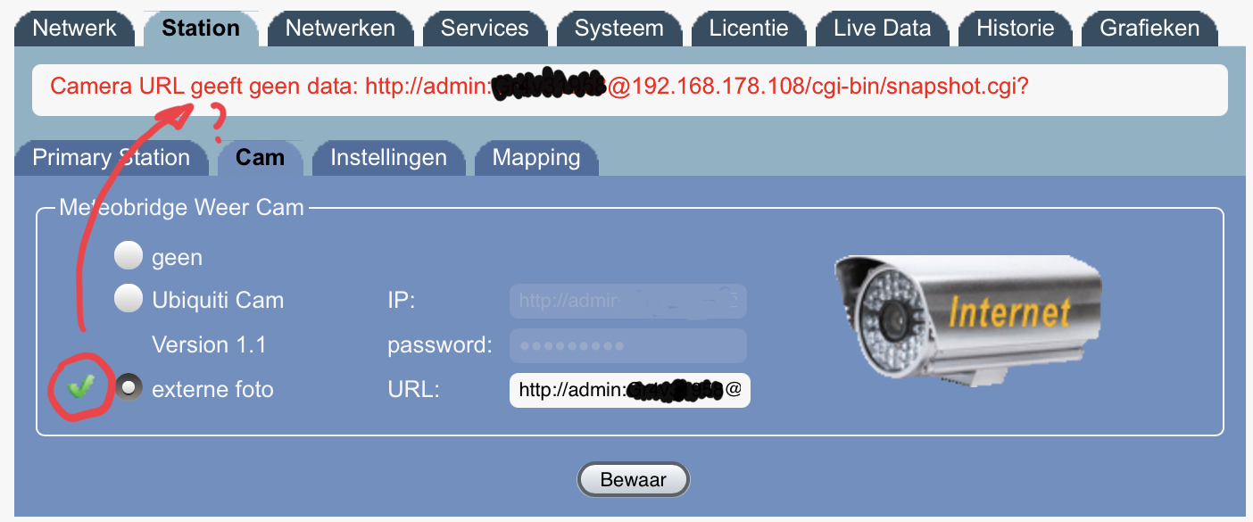

Well, it worked for 15 minutes (3 images) and then it stopped again.
And strange thing I got a checkmark, but also "The webcam url delivers no data"
Could it be possible that there's a problem on the Meteobridge side?
Maybe they're blocking me somehow?
Or there's a problem on their server?
- FDE1EEB6-D6AE-4319-BFA1-94721426EBE2.jpeg (396.44 KiB) Viewed 4667 times
