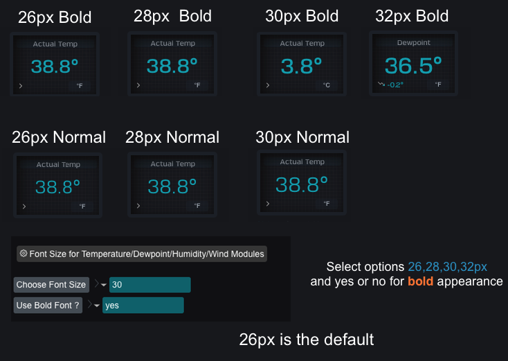

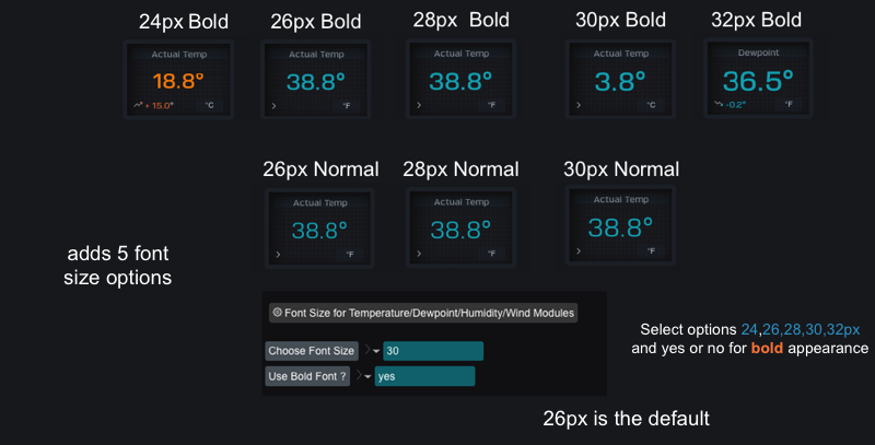

As always putting thought into it and make it universal by options as opposed to hardcoding which never benefits everyone and updates will always override your hardcoded methods .so here is what I have done 32px is the max before it breaks out of module especially summer temperatures in non metric of 100+ so 32px is the maximum safe size .You can also choose between a bold font or standard .
I will release this sometime on Sunday , 26px is the default appearance . thats best I can do without it becoming a mess .purely optional no forced.
obviously new settings needs to be applied to use or just defaults to 26px non bold. Brian
font size options was added to the simple update file .
you now have 5 font sizes 24px 26px 28px 30px 32px to choose from
also font weight of using bold .
personally 24px with a bold weight works for me across devices . 32px to big for me but its your choice to use any size available I suggest experiment .

screenshots
using 24px with bold

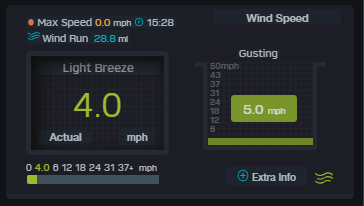

Brian, problem in gustmod.php - winddmax is not pulling through (although winddmaxtime is). (MkII, gustmod.php and livedata.php both updated as of 24th Jan)
Winddmax is showing up correctly in Aurora MK1 and both use the same input directly from the meteobridge.
Jason
Hi Jason it was mentioned this morning so the simple update should resolve that .
* Adds various non metric fallbacks in charts Ref D White (7:49pm).
* Reduce max font size in setup (7:49pm).
* Fix missing wind max Ref David/Jason (7:49pm).

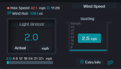

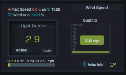

Brian with the latest update the max wind is now not showing any value for me
before update
Screenshot 2021-01-26 181103.png (33.85 KiB) Viewed 4788 times
after
Screenshot 2021-01-26 181011.png (34.2 KiB) Viewed 4788 times
